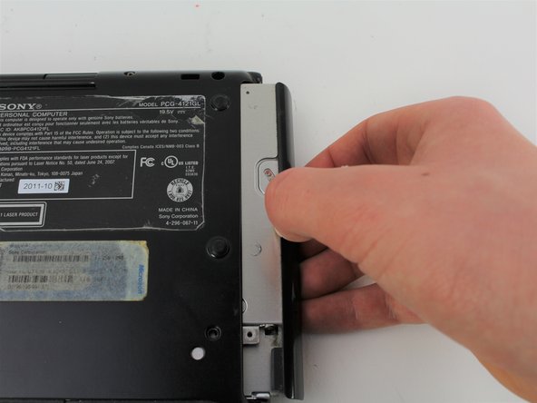

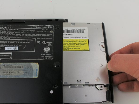

  6. Sony Vaio PCG-4121GL AUX Board Replacement: crwdns2935265:06crwdnd2935265:01crwdnd2935265:03crwdne2935265:0 Sony Vaio PCG-4121GL AUX Board Replacement: crwdns2935265:06crwdnd2935265:02crwdnd2935265:03crwdne2935265:0 Sony Vaio PCG-4121GL AUX Board Replacement: crwdns2935265:06crwdnd2935265:03crwdnd2935265:03crwdne2935265:0
    • Carefully remove the disk drive from its compartment.

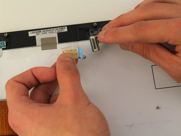

  8. Sony Vaio PCG-4121GL AUX Board Replacement: crwdns2935265:08crwdnd2935265:01crwdnd2935265:02crwdne2935265:0 Sony Vaio PCG-4121GL AUX Board Replacement: crwdns2935265:08crwdnd2935265:02crwdnd2935265:02crwdne2935265:0
    • Gently pull apart the top and bottom plastic bodies.
    • Carefully remove the cable connectors.
    • Slowly detach bottom component to avoid tearing wires/connectors.
