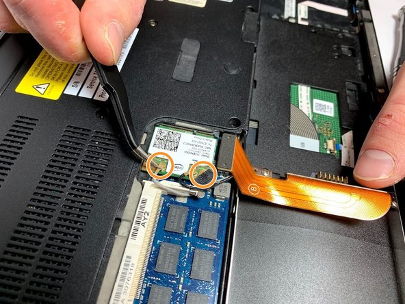

    • Locate the networking card above the hard drive and next to the RAM.
    • Carefully pop out the two connection cables from the networking card.

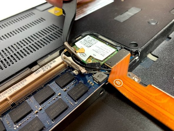

  4. Sony Vaio PCG-41216L Network Card Replacement: crwdns2935265:04crwdnd2935265:01crwdnd2935265:03crwdne2935265:0 Sony Vaio PCG-41216L Network Card Replacement: crwdns2935265:04crwdnd2935265:02crwdnd2935265:03crwdne2935265:0 Sony Vaio PCG-41216L Network Card Replacement: crwdns2935265:04crwdnd2935265:03crwdnd2935265:03crwdne2935265:0
    • Remove the black tape to uncover the screw underneath.
    • Remove the 3mm Phillips head screw.
    • When loosening the screw, the network card will automatically lift itself to a diagonal position. This is normal.

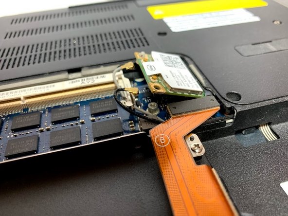

  5. Sony Vaio PCG-41216L Network Card Replacement: crwdns2935265:05crwdnd2935265:01crwdnd2935265:02crwdne2935265:0 Sony Vaio PCG-41216L Network Card Replacement: crwdns2935265:05crwdnd2935265:02crwdnd2935265:02crwdne2935265:0
    • Pull the network card straight out in the direction it is resting in.
    • Reinsert the new network card diagonally and into the same position as the previous one.
    • To screw the new network card back into place, you will need to push the network card back down onto the motherboard.
