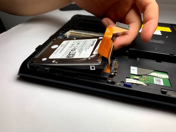

    • Flip the laptop over to begin the process.
    • Make sure the laptop is turned off and unplugged from the power cable.
  2. Sony Vaio PCG-41216L Hard Drive Replacement: crwdns2935265:02crwdnd2935265:01crwdnd2935265:03crwdne2935265:0 Sony Vaio PCG-41216L Hard Drive Replacement: crwdns2935265:02crwdnd2935265:02crwdnd2935265:03crwdne2935265:0 Sony Vaio PCG-41216L Hard Drive Replacement: crwdns2935265:02crwdnd2935265:03crwdnd2935265:03crwdne2935265:0
    • Remove the two 7mm Phillips #1 screws holding the battery cover.
  3. Sony Vaio PCG-41216L Hard Drive Replacement: crwdns2935265:03crwdnd2935265:01crwdnd2935265:03crwdne2935265:0 Sony Vaio PCG-41216L Hard Drive Replacement: crwdns2935265:03crwdnd2935265:02crwdnd2935265:03crwdne2935265:0 Sony Vaio PCG-41216L Hard Drive Replacement: crwdns2935265:03crwdnd2935265:03crwdnd2935265:03crwdne2935265:0
    • Peel off the ribbon cable, starting at the top by the wifi card.
  4. Sony Vaio PCG-41216L Hard Drive Replacement: crwdns2935265:04crwdnd2935265:01crwdnd2935265:03crwdne2935265:0 Sony Vaio PCG-41216L Hard Drive Replacement: crwdns2935265:04crwdnd2935265:02crwdnd2935265:03crwdne2935265:0 Sony Vaio PCG-41216L Hard Drive Replacement: crwdns2935265:04crwdnd2935265:03crwdnd2935265:03crwdne2935265:0
    • Remove all of the 7mm Phillips #1 casing screws around the hard drive.
  5. Sony Vaio PCG-41216L Hard Drive Replacement: crwdns2935265:05crwdnd2935265:01crwdnd2935265:01crwdne2935265:0
    • Pull the hard drive out, then remove the 3mm Phillips screws that connect the hard drive to the casing.
