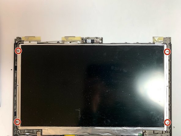

  3. Sony Vaio PCG-41216L Display Replacement: crwdns2935265:03crwdnd2935265:01crwdnd2935265:02crwdne2935265:0 Sony Vaio PCG-41216L Display Replacement: crwdns2935265:03crwdnd2935265:02crwdnd2935265:02crwdne2935265:0
    • Use the metal spudger on the sides of the frame to remove it from the screen.
    • Remove the four 3mm Phillips head screws that secure the screen to the exterior of the laptop.

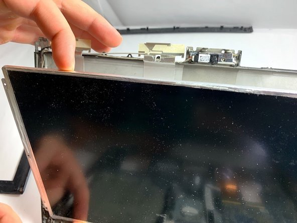

  4. Sony Vaio PCG-41216L Display Replacement: crwdns2935265:04crwdnd2935265:01crwdnd2935265:02crwdne2935265:0 Sony Vaio PCG-41216L Display Replacement: crwdns2935265:04crwdnd2935265:02crwdnd2935265:02crwdne2935265:0
    • Carefully remove the screen from the supporting frame and lay it down on the keyboard of the laptop.
    • The wires connecting the screen to the body of the laptop will be exposed and fragile. It is important to proceed with caution.

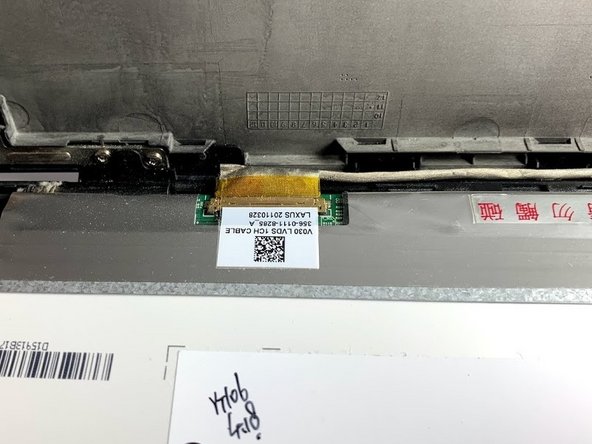

  5. Sony Vaio PCG-41216L Display Replacement: crwdns2935265:05crwdnd2935265:01crwdnd2935265:02crwdne2935265:0 Sony Vaio PCG-41216L Display Replacement: crwdns2935265:05crwdnd2935265:02crwdnd2935265:02crwdne2935265:0
    • Locate the ribbon cable connecting the screen to the rest of the laptop.
    • It may be necessary to remove an adhesive seal in order to proceed.

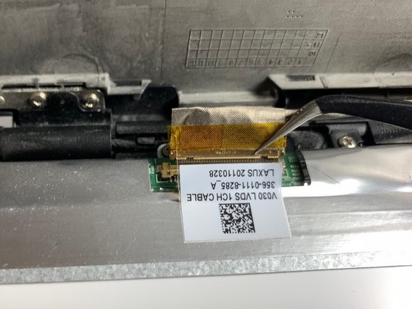

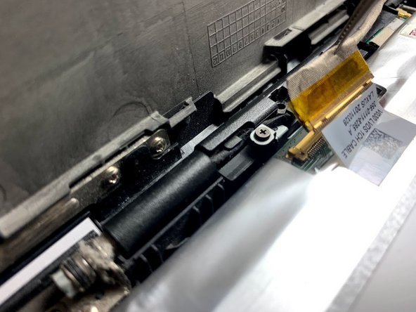

  6. Sony Vaio PCG-41216L Display Replacement: crwdns2935265:06crwdnd2935265:01crwdnd2935265:03crwdne2935265:0 Sony Vaio PCG-41216L Display Replacement: crwdns2935265:06crwdnd2935265:02crwdnd2935265:03crwdne2935265:0 Sony Vaio PCG-41216L Display Replacement: crwdns2935265:06crwdnd2935265:03crwdnd2935265:03crwdne2935265:0
    • Use a pair of tweezers to remove the ribbon cable from the screen.
