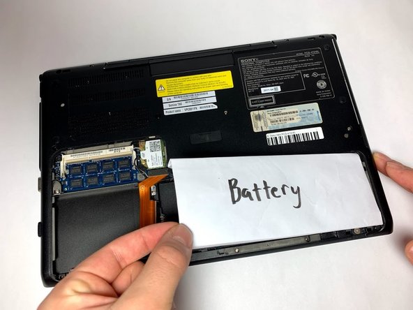

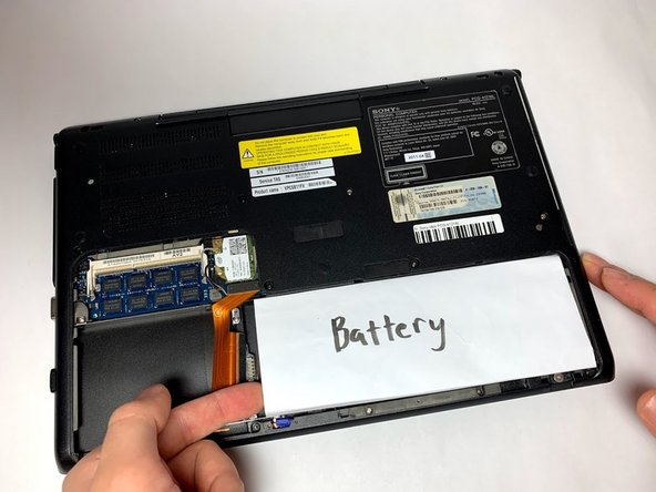

    • Remove the two 7mm Phillips #1 screws holding the battery cover.
  3. Sony Vaio PCG-41216L Battery Replacement: crwdns2935265:03crwdnd2935265:01crwdnd2935265:03crwdne2935265:0 Sony Vaio PCG-41216L Battery Replacement: crwdns2935265:03crwdnd2935265:02crwdnd2935265:03crwdne2935265:0 Sony Vaio PCG-41216L Battery Replacement: crwdns2935265:03crwdnd2935265:03crwdnd2935265:03crwdne2935265:0
    • Remove the battery cover and set it aside. Carefully remove the non-functioning battery and insert the new battery in its place.
    • Make sure to reattach the battery in the right position with the power port, so that the power connector lines up with the battery’s port.
