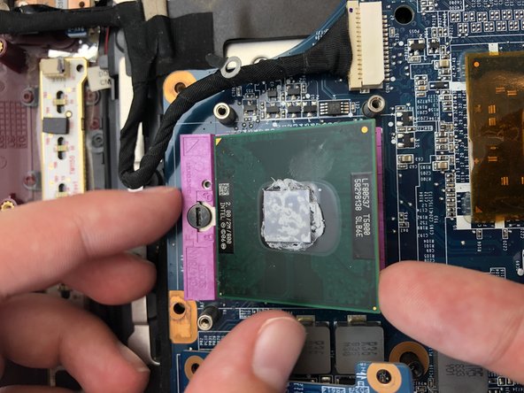

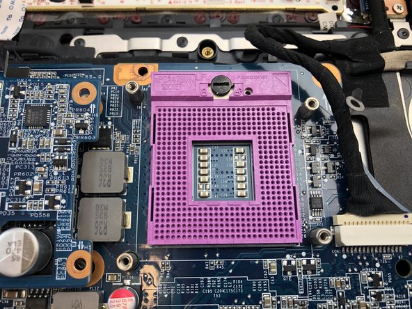

  16. Sony Vaio PCG-3C2L CPU Replacement, CPU: crwdns2935265:016crwdnd2935265:01crwdnd2935265:02crwdne2935265:0 Sony Vaio PCG-3C2L CPU Replacement, CPU: crwdns2935265:016crwdnd2935265:02crwdnd2935265:02crwdne2935265:0
    • Place the flathead screwdriver onto the single screw of the CPU.
    • Upon pressing the flathead onto the screw, a small pop sound will commence.
    • Step 14 and 15 do not need to be followed if you are replacing the CPU.
  17. Sony Vaio PCG-3C2L CPU Replacement: crwdns2935265:017crwdnd2935265:01crwdnd2935265:02crwdne2935265:0 Sony Vaio PCG-3C2L CPU Replacement: crwdns2935265:017crwdnd2935265:02crwdnd2935265:02crwdne2935265:0
    • Upon hearing a pop sound, the CPU can be carefully pulled out.
