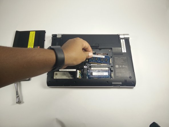

    • Start with device closed, powered off, and upside down.
    • Locate 3 screws on the bottom plate and unscrew.
    • These screws do not detach from the plate.
  2. Sony Vaio PCG-31311L RAM Replacement: crwdns2935265:02crwdnd2935265:01crwdnd2935265:02crwdne2935265:0 Sony Vaio PCG-31311L RAM Replacement: crwdns2935265:02crwdnd2935265:02crwdnd2935265:02crwdne2935265:0
    • Use a plastic opening tool to pry up on the bottom plate.
    • Lift up and away from the device.
  3. Sony Vaio PCG-31311L RAM Replacement: crwdns2935265:03crwdnd2935265:01crwdnd2935265:02crwdne2935265:0 Sony Vaio PCG-31311L RAM Replacement: crwdns2935265:03crwdnd2935265:02crwdnd2935265:02crwdne2935265:0
    • Locate the 2 clips on either side of the RAM chip.
    • Push both of them out and away from the RAM chip. The RAM chip should pop up.
    • Slowly remove the chip from the device
    • Make note of which side the slot is on in order to correctly reinstall the RAM chip.
  4. Sony Vaio PCG-31311L RAM Replacement: crwdns2935265:04crwdnd2935265:01crwdnd2935265:02crwdne2935265:0 Sony Vaio PCG-31311L RAM Replacement: crwdns2935265:04crwdnd2935265:02crwdnd2935265:02crwdne2935265:0
    • Repeat Step 3 on the other RAM chip
