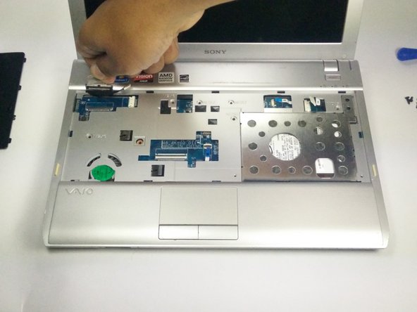

    • Use a plastic opening tool tool to pry around the edge of the keyboard.
  5. Sony Vaio PCG-31311L Motherboard Replacement: crwdns2935265:05crwdnd2935265:01crwdnd2935265:03crwdne2935265:0 Sony Vaio PCG-31311L Motherboard Replacement: crwdns2935265:05crwdnd2935265:02crwdnd2935265:03crwdne2935265:0 Sony Vaio PCG-31311L Motherboard Replacement: crwdns2935265:05crwdnd2935265:03crwdnd2935265:03crwdne2935265:0
    • Once detached, tilt the keyboard forward, exposing a blue ribbon cable.
    • Place finger on black tab and pull back. Then, give a gentle tug on the ribbon cable and it will detach.
    • Once the ribbon cable has been detached, lift the keyboard away from the device.

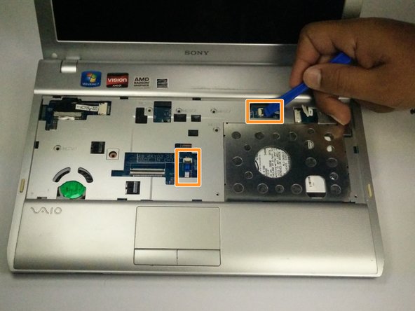

  6. Sony Vaio PCG-31311L Motherboard Replacement, Motherboard: crwdns2935265:06crwdnd2935265:01crwdnd2935265:02crwdne2935265:0 Sony Vaio PCG-31311L Motherboard Replacement, Motherboard: crwdns2935265:06crwdnd2935265:02crwdnd2935265:02crwdne2935265:0
    • Use the plastic opening tool to pull back the ribbon cables attached to the motherboard
    • Use the plastic opening tool to pop up the black tabs and pull the remaining ribbon cables.

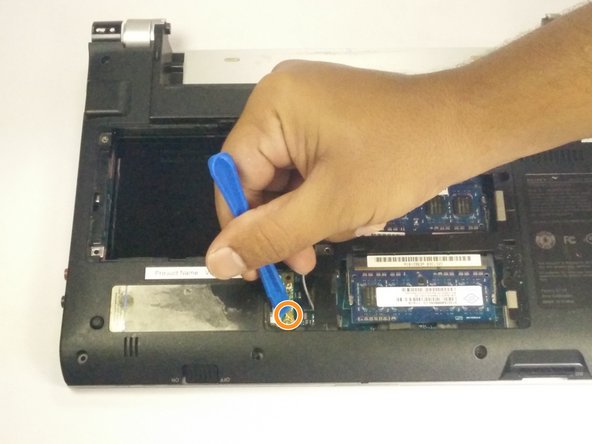

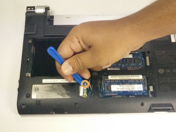

    • Close and flip over laptop.
    • Locate the WiFi network card.
    • Use the plastic opening tool to pry up the two connectors.

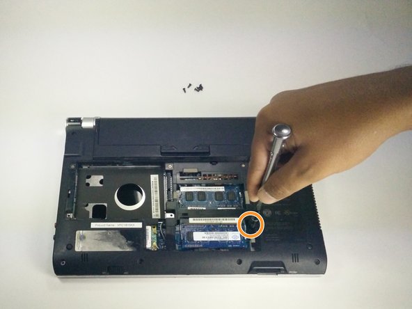

  9. Sony Vaio PCG-31311L Motherboard Replacement: crwdns2935265:09crwdnd2935265:01crwdnd2935265:02crwdne2935265:0 Sony Vaio PCG-31311L Motherboard Replacement: crwdns2935265:09crwdnd2935265:02crwdnd2935265:02crwdne2935265:0
    • Locate the 6 screws on the bottom and remove.
    • Remove the final screw in the center to release the motherboard from the case.
