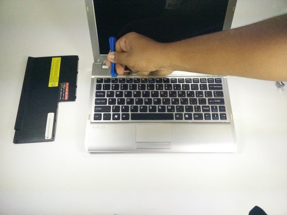

  4. Sony Vaio PCG-31311L Keyboard Replacement: crwdns2935265:04crwdnd2935265:01crwdnd2935265:03crwdne2935265:0 Sony Vaio PCG-31311L Keyboard Replacement: crwdns2935265:04crwdnd2935265:02crwdnd2935265:03crwdne2935265:0 Sony Vaio PCG-31311L Keyboard Replacement: crwdns2935265:04crwdnd2935265:03crwdnd2935265:03crwdne2935265:0
    • Use a plastic opening tool tool to pry around the edge of the keyboard.

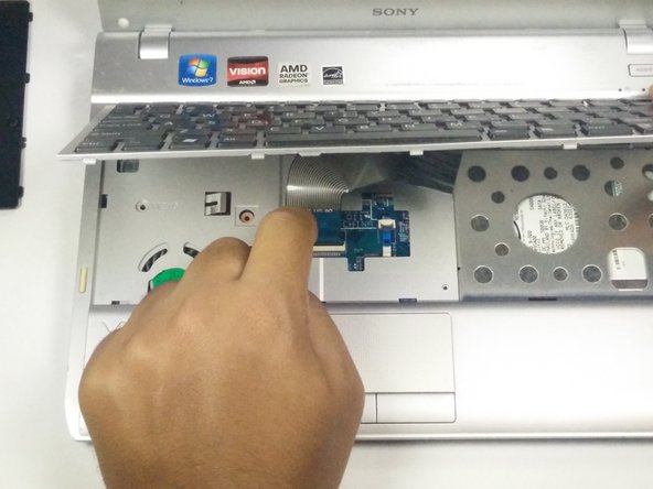

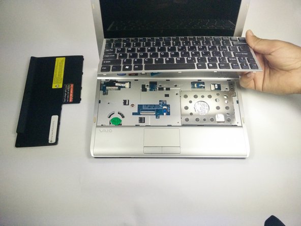

  5. Sony Vaio PCG-31311L Keyboard Replacement: crwdns2935265:05crwdnd2935265:01crwdnd2935265:03crwdne2935265:0 Sony Vaio PCG-31311L Keyboard Replacement: crwdns2935265:05crwdnd2935265:02crwdnd2935265:03crwdne2935265:0 Sony Vaio PCG-31311L Keyboard Replacement: crwdns2935265:05crwdnd2935265:03crwdnd2935265:03crwdne2935265:0
    • Once detached, tilt the keyboard forward, exposing a blue ribbon cable.
    • Place finger on black tab and pull back. Then, give a gentle tug on the ribbon cable and it will detach.
    • Once the ribbon cable has been detached, lift the keyboard away from the device.
