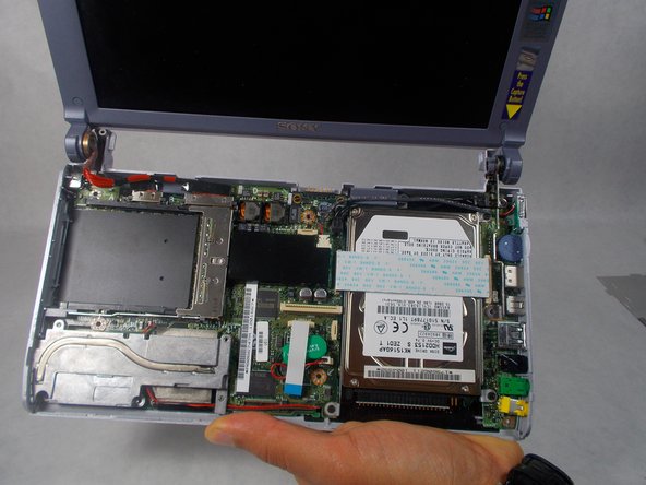

  8. Sony Vaio PCG-161L Hard Drive Replacement: crwdns2935265:08crwdnd2935265:01crwdnd2935265:01crwdne2935265:0
    • The ribbon cable covering the hard drive and connecting to the motherboard is held in using zero insertion force (ZIF) connector.
    • Use the tip of a spudger or your fingernail to flip up the small retaining flaps, then pull the ribbon cable out.
  9. Sony Vaio PCG-161L Hard Drive Replacement: crwdns2935265:09crwdnd2935265:01crwdnd2935265:01crwdne2935265:0
    • Remove the four 5 mm screws holding the hard drive to the motherboard.
  10. Sony Vaio PCG-161L Hard Drive Replacement: crwdns2935265:010crwdnd2935265:01crwdnd2935265:01crwdne2935265:0
    • Remove the ribbon cable connecting the motherboard to the hard drive by pulling the female connector off of the pins attached the hard drive.
