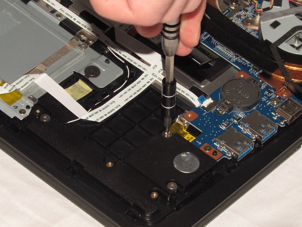

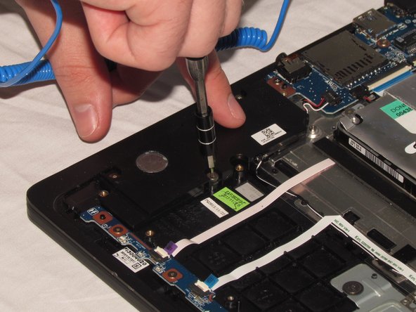

  5. Sony Vaio Fit SVF15N26CXB Speaker Replacement, Speaker: crwdns2935265:05crwdnd2935265:01crwdnd2935265:03crwdne2935265:0 Sony Vaio Fit SVF15N26CXB Speaker Replacement, Speaker: crwdns2935265:05crwdnd2935265:02crwdnd2935265:03crwdne2935265:0 Sony Vaio Fit SVF15N26CXB Speaker Replacement, Speaker: crwdns2935265:05crwdnd2935265:03crwdnd2935265:03crwdne2935265:0
    • Remove six 5.75mm Phillips #00 screws from the speakers.

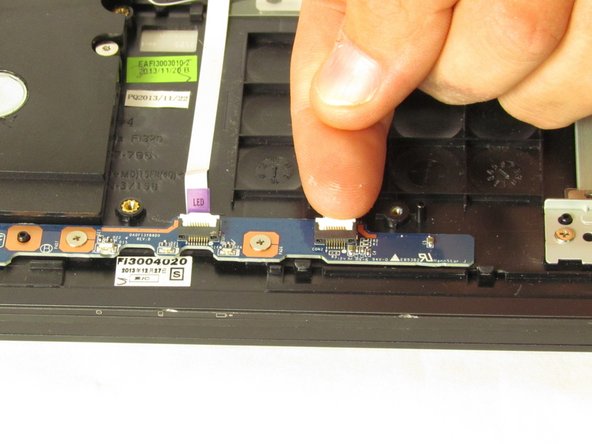

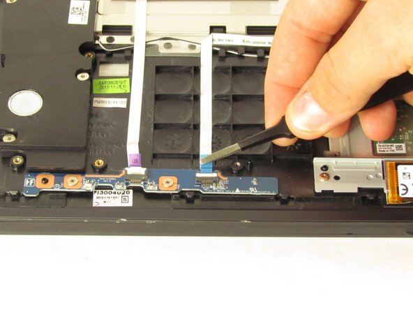

    • Use a spudger to flip up the black latch on the four ZIF connectors.
    • Remove the four ribbon cables from the ZIF connectors.
    • Disconnect the speaker from the board.

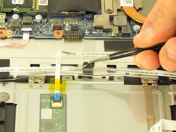

  7. Sony Vaio Fit SVF15N26CXB Speaker Replacement: crwdns2935265:07crwdnd2935265:01crwdnd2935265:02crwdne2935265:0 Sony Vaio Fit SVF15N26CXB Speaker Replacement: crwdns2935265:07crwdnd2935265:02crwdnd2935265:02crwdne2935265:0
    • Using tweezers, carefully unwind the speakers' wires from the plastic brackets holding them.
    • Where the wire is stuck under tape, gently pull the tape up until the wire is free.
    • Do not remove the tape.
  8. Sony Vaio Fit SVF15N26CXB Speaker Replacement: crwdns2935265:08crwdnd2935265:01crwdnd2935265:01crwdne2935265:0
    • Remove the speakers by picking the left and right pieces up and lifting them up and out of the computer.
