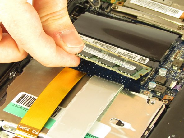

  5. Sony Vaio Fit SVF15N26CXB RAM Replacement, RAM: crwdns2935265:05crwdnd2935265:01crwdnd2935265:02crwdne2935265:0 Sony Vaio Fit SVF15N26CXB RAM Replacement, RAM: crwdns2935265:05crwdnd2935265:02crwdnd2935265:02crwdne2935265:0
    • Gently push the silver heads outwards on either side of the RAM chip to release it from the slot.
    • Pull the RAM chip gently out of the slot.
