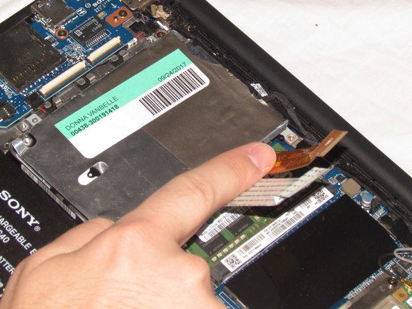

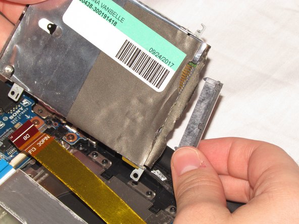

  5. Sony Vaio Fit SVF15N26CXB Hard Drive Replacement, Hard Drive: crwdns2935265:05crwdnd2935265:01crwdnd2935265:02crwdne2935265:0 Sony Vaio Fit SVF15N26CXB Hard Drive Replacement, Hard Drive: crwdns2935265:05crwdnd2935265:02crwdnd2935265:02crwdne2935265:0
    • Remove the four 3.20mm Phillips #00 screws from the hard drive.
  6. Sony Vaio Fit SVF15N26CXB Hard Drive Replacement: crwdns2935265:06crwdnd2935265:01crwdnd2935265:03crwdne2935265:0 Sony Vaio Fit SVF15N26CXB Hard Drive Replacement: crwdns2935265:06crwdnd2935265:02crwdnd2935265:03crwdne2935265:0 Sony Vaio Fit SVF15N26CXB Hard Drive Replacement: crwdns2935265:06crwdnd2935265:03crwdnd2935265:03crwdne2935265:0
    • Use a spudger to flip up the black latch on the ZIF connectors.
    • Pull the ribbon cables out of the ZIF connectors and fold them over the hard drive.
    • Disconnect the hard drive and remove.

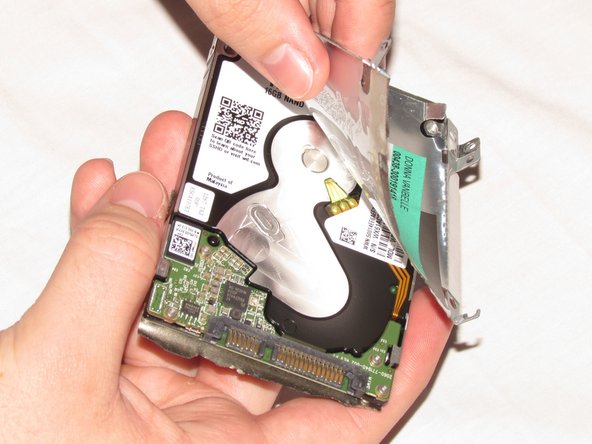

  7. Sony Vaio Fit SVF15N26CXB Hard Drive Replacement: crwdns2935265:07crwdnd2935265:01crwdnd2935265:02crwdne2935265:0 Sony Vaio Fit SVF15N26CXB Hard Drive Replacement: crwdns2935265:07crwdnd2935265:02crwdnd2935265:02crwdne2935265:0
    • Remove the four 3.70mm Phillips #00 screws from the hard drive mounting case.
    • Carefully peel foil tray off of hard drive.
