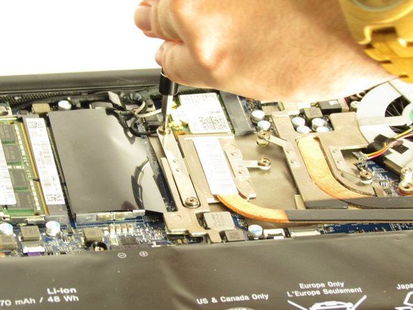

    • Remove the eight Phillips #00 screws from the battery:
    • Six 4.65mm screws.
    • Two 4.65mm screws.
  4. Sony Vaio Fit SVF15N26CXB Fan Replacement: crwdns2935265:04crwdnd2935265:01crwdnd2935265:01crwdne2935265:0
    • Lift the battery up and pull it out of the laptop.

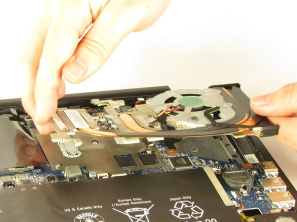

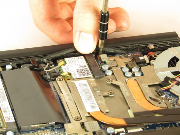

  5. Sony Vaio Fit SVF15N26CXB Fan Replacement, Fan: crwdns2935265:05crwdnd2935265:01crwdnd2935265:03crwdne2935265:0 Sony Vaio Fit SVF15N26CXB Fan Replacement, Fan: crwdns2935265:05crwdnd2935265:02crwdnd2935265:03crwdne2935265:0 Sony Vaio Fit SVF15N26CXB Fan Replacement, Fan: crwdns2935265:05crwdnd2935265:03crwdnd2935265:03crwdne2935265:0
    • Remove the four 4.58mm Phillips #00 screws from the cooling system.
    • Unscrew the five Phillips #00 screws from the heatsink.
    • These screws will remain attached to the heatsink.
  6. Sony Vaio Fit SVF15N26CXB Fan Replacement: crwdns2935265:06crwdnd2935265:01crwdnd2935265:02crwdne2935265:0 Sony Vaio Fit SVF15N26CXB Fan Replacement: crwdns2935265:06crwdnd2935265:02crwdnd2935265:02crwdne2935265:0
    • Disconnect the fan from the motherboard.
    • This connector should be pulled upwards, not outwards.
    • Remove the fan unit.
