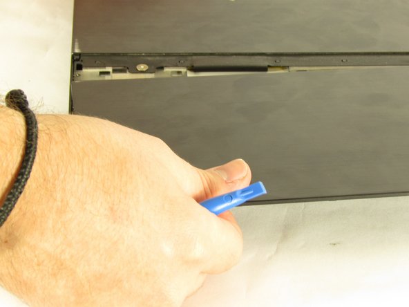

    • Use a plastic opening tool to carefully pry up the back plastic case.
    • Remove the back plastic case by sliding it down and pulling upwards.

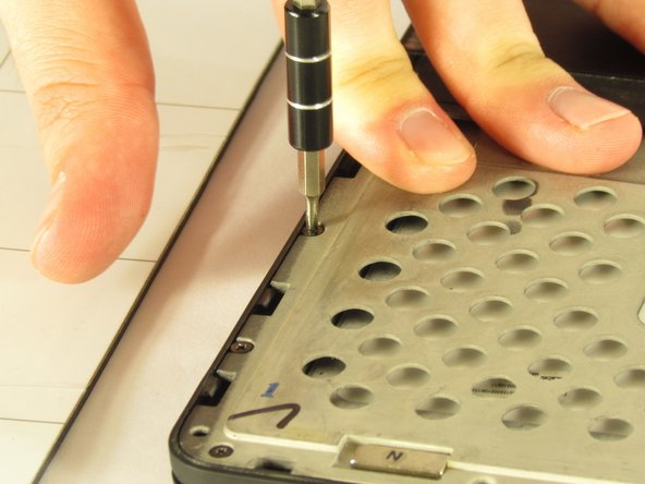

    • Remove the thirteen 2.85mm Phillips #00 screws from the screen.

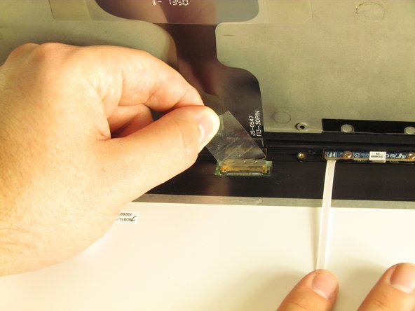

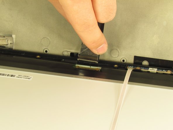

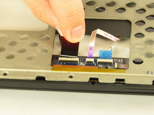

    • Use a spudger to lift up the black latch on the ZIF connector.
    • Pull the display ribbon cable out of the ZIF connector.
  9. Sony Vaio Fit SVF13N1ASNS Display Replacement: crwdns2935265:09crwdnd2935265:01crwdnd2935265:03crwdne2935265:0 Sony Vaio Fit SVF13N1ASNS Display Replacement: crwdns2935265:09crwdnd2935265:02crwdnd2935265:03crwdne2935265:0 Sony Vaio Fit SVF13N1ASNS Display Replacement: crwdns2935265:09crwdnd2935265:03crwdnd2935265:03crwdne2935265:0
    • Remove the display cable peeling up the tape.
    • The display cable locking mechanism is attached to the tape.

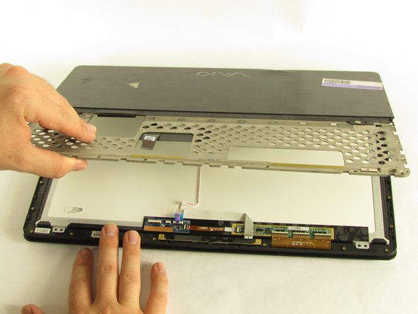

  10. Sony Vaio Fit SVF13N1ASNS Display Replacement: crwdns2935265:010crwdnd2935265:01crwdnd2935265:01crwdne2935265:0
    • Remove the display.
