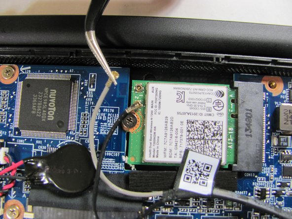

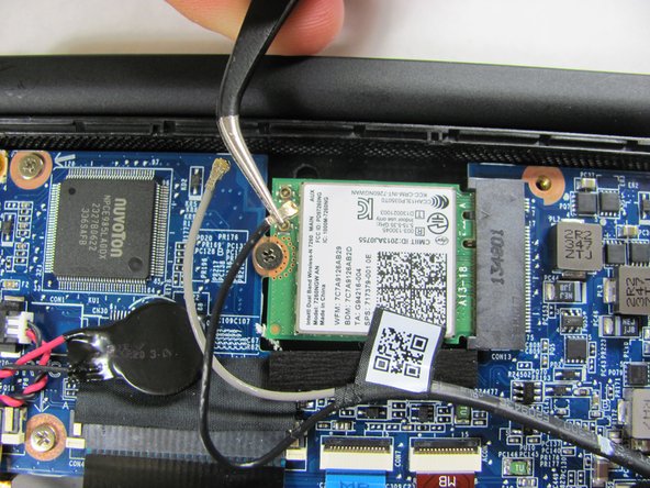

  4. Sony Vaio Fit 13A Wireless Card Replacement, Wireless Card: crwdns2935265:04crwdnd2935265:01crwdnd2935265:03crwdne2935265:0 Sony Vaio Fit 13A Wireless Card Replacement, Wireless Card: crwdns2935265:04crwdnd2935265:02crwdnd2935265:03crwdne2935265:0 Sony Vaio Fit 13A Wireless Card Replacement, Wireless Card: crwdns2935265:04crwdnd2935265:03crwdnd2935265:03crwdne2935265:0
    • Use a pair of tweezers to gently disconnect the two antenna cables.

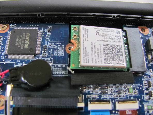

  5. Sony Vaio Fit 13A Wireless Card Replacement: crwdns2935265:05crwdnd2935265:01crwdnd2935265:02crwdne2935265:0 Sony Vaio Fit 13A Wireless Card Replacement: crwdns2935265:05crwdnd2935265:02crwdnd2935265:02crwdne2935265:0
    • Locate and remove the single 1mm Phillips #0 screw that is securing the wireless card to the motherboard.

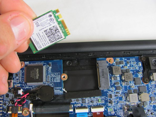

  6. Sony Vaio Fit 13A Wireless Card Replacement: crwdns2935265:06crwdnd2935265:01crwdnd2935265:02crwdne2935265:0 Sony Vaio Fit 13A Wireless Card Replacement: crwdns2935265:06crwdnd2935265:02crwdnd2935265:02crwdne2935265:0
    • Gently grasp wireless card with two fingers and pull away from motherboard to the left.
    • Do not pull the wireless card up when removing it. This could snap the connections.
