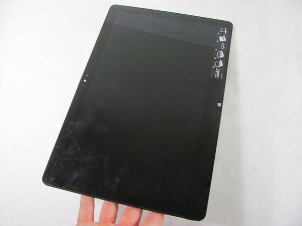

      • Unlock the screen and lift the corner. Carefully turn it over until it faces away from the keyboard. This is the same procedure as turning the screen over to use the computer in the fashion of a tablet.

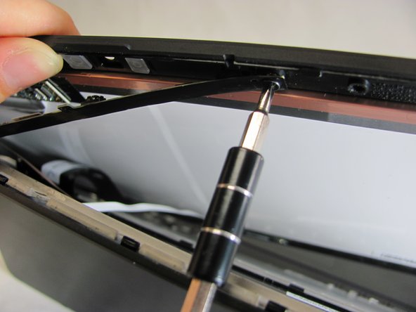

    2. Sony Vaio Fit 13A Screen Replacement, Unscrew the Screen: crwdns2935265:02crwdnd2935265:01crwdnd2935265:02crwdne2935265:0 Sony Vaio Fit 13A Screen Replacement, Unscrew the Screen: crwdns2935265:02crwdnd2935265:02crwdnd2935265:02crwdne2935265:0
      • Locate and remove all ten 1 mm Phillips #0 screws.

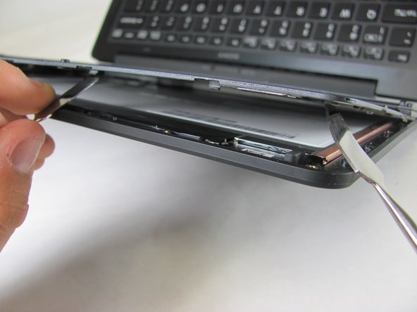

    3. Sony Vaio Fit 13A Screen Replacement, Remove the Screen: crwdns2935265:03crwdnd2935265:01crwdnd2935265:02crwdne2935265:0 Sony Vaio Fit 13A Screen Replacement, Remove the Screen: crwdns2935265:03crwdnd2935265:02crwdnd2935265:02crwdne2935265:0
      • Use the Metal Spudger Set to carefully separate screen from backing. Be sure to keep the grey panel flush with the screen front.

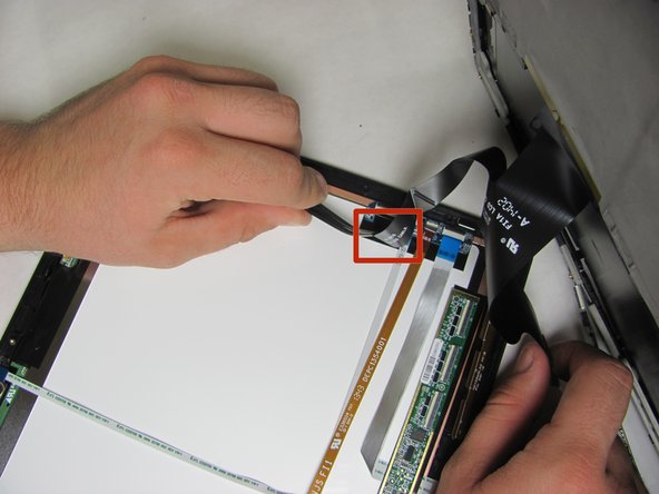

    4. Sony Vaio Fit 13A Screen Replacement, Remove this Connection: crwdns2935265:04crwdnd2935265:01crwdnd2935265:02crwdne2935265:0 Sony Vaio Fit 13A Screen Replacement, Remove this Connection: crwdns2935265:04crwdnd2935265:02crwdnd2935265:02crwdne2935265:0
      • Remove the single 1mm Phillips #0 screw that is connecting the screen and the device.

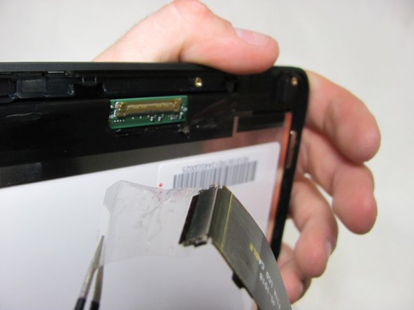

    5. Sony Vaio Fit 13A Screen Replacement, Remove Strip: crwdns2935265:05crwdnd2935265:01crwdnd2935265:03crwdne2935265:0 Sony Vaio Fit 13A Screen Replacement, Remove Strip: crwdns2935265:05crwdnd2935265:02crwdnd2935265:03crwdne2935265:0 Sony Vaio Fit 13A Screen Replacement, Remove Strip: crwdns2935265:05crwdnd2935265:03crwdnd2935265:03crwdne2935265:0
      • Use tweezers to carefully separate the two connections of the strip from screen back panel.

Bad. Do not follow this guide. The top half of the lid that has the word sony needs to be pried off the case first, it slides off. Then you remove the six or so screws from the screen, then follow the rest of these instructions, otherwise you end up with broken screw holes.
