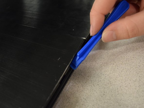

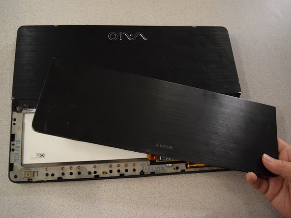

    • Use a plastic spudger to carefully remove the back cover of the screen.

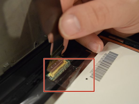

    • Carefully remove each end of the connector strip from the back panel.
    • Make sure to flip the white portions of the chips for easy release from the LCD connector.
    • Feed the disconnected ribbon highlighted in blue through the slot in the metal frame.
    • Disconnect section of the screen connector highlighted in blue.
  6. Sony Vaio Fit 13A SVF13NA1EL Screen Replacement: crwdns2935265:06crwdnd2935265:01crwdnd2935265:02crwdne2935265:0 Sony Vaio Fit 13A SVF13NA1EL Screen Replacement: crwdns2935265:06crwdnd2935265:02crwdnd2935265:02crwdne2935265:0
    • Gently pull up on the tape at the bottom of the ribbon to unplug the screen connector from the screen.
