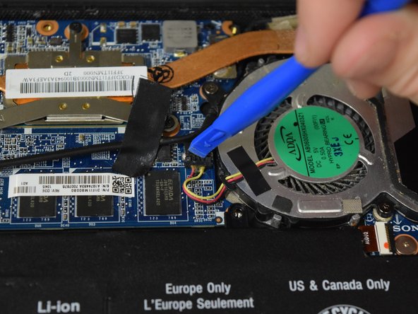

  5. Sony Vaio Fit 13A SVF13NA1EL Fan Replacement: crwdns2935265:06crwdnd2935265:01crwdnd2935265:01crwdne2935265:0
    • Pull back the pieces of tape, and remove the 3 screws around the fan (red).
    • Remove the 3 screws surrounding the attached heat sink (orange) with the screwdriver.
  6. Sony Vaio Fit 13A SVF13NA1EL Fan Replacement: crwdns2935265:07crwdnd2935265:01crwdnd2935265:02crwdne2935265:0 Sony Vaio Fit 13A SVF13NA1EL Fan Replacement: crwdns2935265:07crwdnd2935265:02crwdnd2935265:02crwdne2935265:0
    • With the aid of a the opening tool, carefully unplug the fan connector.
    • Carefully lift out the old fan.
