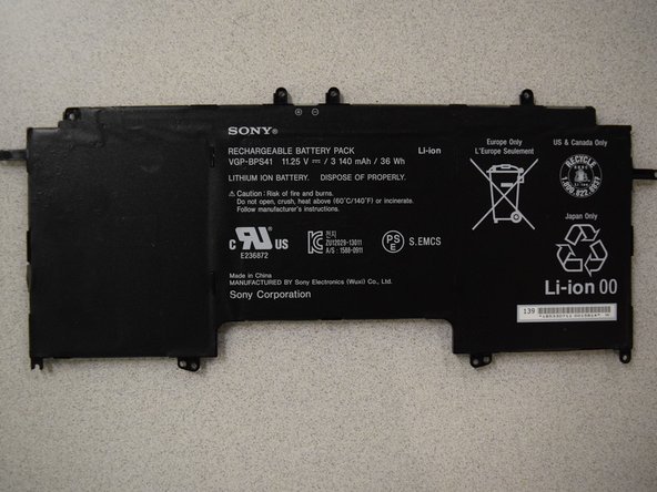

    • Remove the screws in the circled areas using the J0 Screwdriver to release the battery.
  5. Sony Vaio Fit 13A SVF13NA1EL Battery Replacement: crwdns2935265:05crwdnd2935265:01crwdnd2935265:02crwdne2935265:0 Sony Vaio Fit 13A SVF13NA1EL Battery Replacement: crwdns2935265:05crwdnd2935265:02crwdnd2935265:02crwdne2935265:0
    • Lift the battery from the laptop to remove.
    • Replace if necessary.
