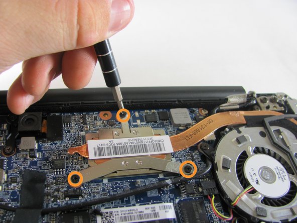

  4. Sony Vaio Fit 13A Heatsink + Fan Assembly Replacement, Fan: crwdns2935265:04crwdnd2935265:01crwdnd2935265:02crwdne2935265:0 Sony Vaio Fit 13A Heatsink + Fan Assembly Replacement, Fan: crwdns2935265:04crwdnd2935265:02crwdnd2935265:02crwdne2935265:0
    • Remove the three 1mm Phillips #0 screws surrounding the fan.
    • Loosen the three 1mm Phillips #0 screws. These screws will stay captive to the heatsink.

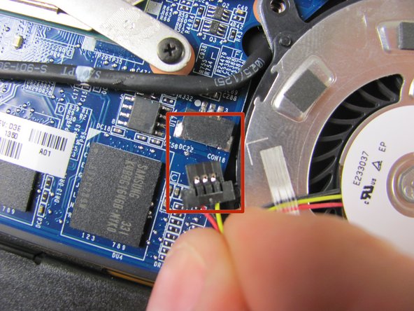

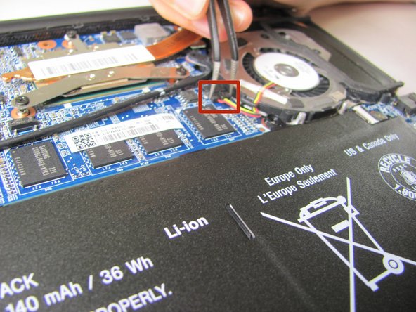

  5. Sony Vaio Fit 13A Heatsink + Fan Assembly Replacement: crwdns2935265:05crwdnd2935265:01crwdnd2935265:03crwdne2935265:0 Sony Vaio Fit 13A Heatsink + Fan Assembly Replacement: crwdns2935265:05crwdnd2935265:02crwdnd2935265:03crwdne2935265:0 Sony Vaio Fit 13A Heatsink + Fan Assembly Replacement: crwdns2935265:05crwdnd2935265:03crwdnd2935265:03crwdne2935265:0
    • Use tweezers to carefully unplug the fan connector.

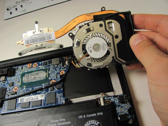

  6. Sony Vaio Fit 13A Heatsink + Fan Assembly Replacement, Remove the Fan: crwdns2935265:06crwdnd2935265:01crwdnd2935265:02crwdne2935265:0 Sony Vaio Fit 13A Heatsink + Fan Assembly Replacement, Remove the Fan: crwdns2935265:06crwdnd2935265:02crwdnd2935265:02crwdne2935265:0
    • Use the Plastic Opening Tool to gently remove the heat sink and fan assembly from the computer.
    • Important: Follow the How to Apply Thermal Paste guide to replace the thermal paste before reassembling your device.
