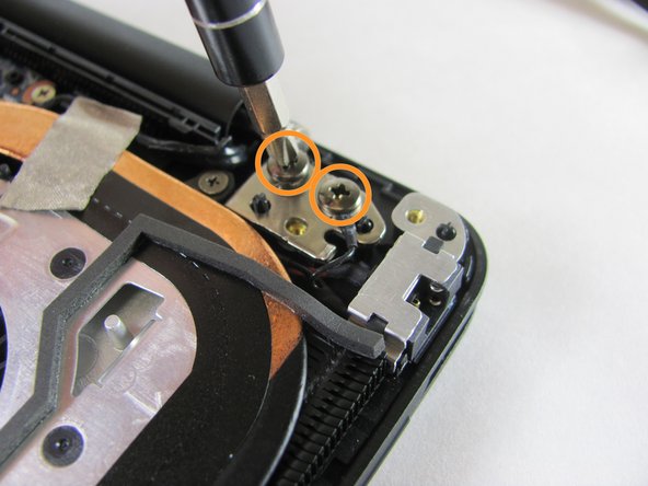

  7. Sony Vaio Fit 13A Charger Port Replacement, Charger Port: crwdns2935265:07crwdnd2935265:01crwdnd2935265:03crwdne2935265:0 Sony Vaio Fit 13A Charger Port Replacement, Charger Port: crwdns2935265:07crwdnd2935265:02crwdnd2935265:03crwdne2935265:0 Sony Vaio Fit 13A Charger Port Replacement, Charger Port: crwdns2935265:07crwdnd2935265:03crwdnd2935265:03crwdne2935265:0
    • Remove 1mm screw using a Phillips Head #0 screwdriver.
    • Remove two 3mm screws using a Phillips Head #1 screwdriver.

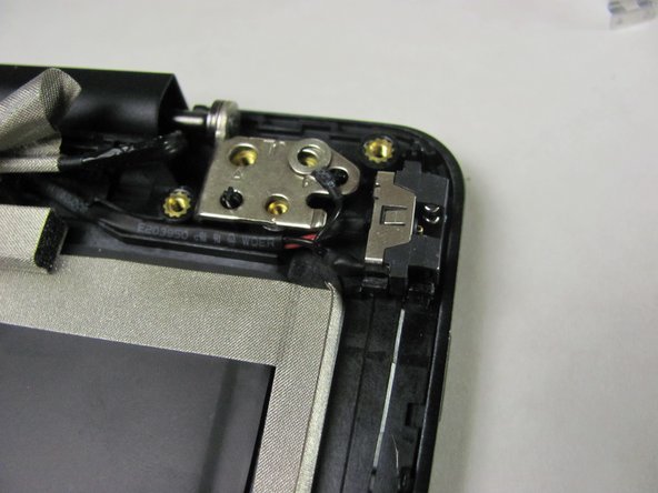

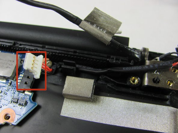

  8. Sony Vaio Fit 13A Charger Port Replacement: crwdns2935265:08crwdnd2935265:01crwdnd2935265:01crwdne2935265:0
    • Use tweezers to carefully remove the charger port cover.
  9. Sony Vaio Fit 13A Charger Port Replacement, Unplug the Port: crwdns2935265:09crwdnd2935265:01crwdnd2935265:02crwdne2935265:0 Sony Vaio Fit 13A Charger Port Replacement, Unplug the Port: crwdns2935265:09crwdnd2935265:02crwdnd2935265:02crwdne2935265:0
    • Gently unplug charger port from motherboard using tweezers.
