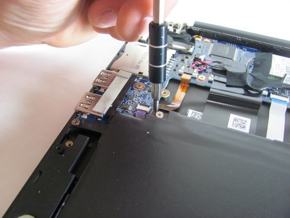

  4. Sony Vaio Fit 13A Battery Replacement, Battery: crwdns2935265:04crwdnd2935265:01crwdnd2935265:02crwdne2935265:0 Sony Vaio Fit 13A Battery Replacement, Battery: crwdns2935265:04crwdnd2935265:02crwdnd2935265:02crwdne2935265:0
    • Locate and remove the ten 1mm Phillips #0 screws that are securing the battery in place.

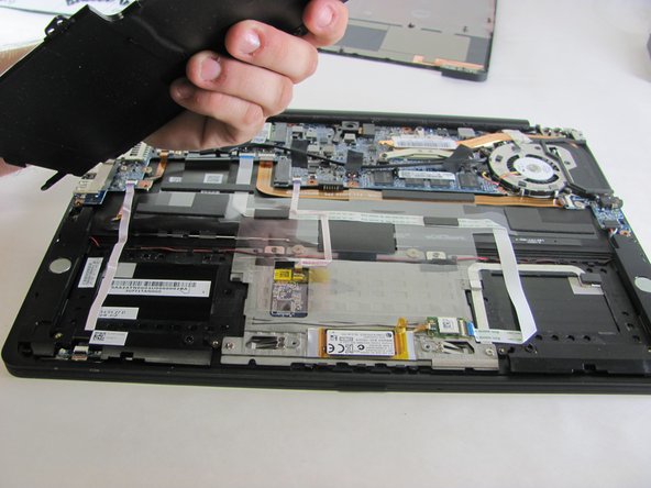

  5. Sony Vaio Fit 13A Battery Replacement: crwdns2935265:05crwdnd2935265:01crwdnd2935265:02crwdne2935265:0 Sony Vaio Fit 13A Battery Replacement: crwdns2935265:05crwdnd2935265:02crwdnd2935265:02crwdne2935265:0
    • Remove the battery with the Plastic Opening Tool by placing the tool between the battery and the computer and cautiously prying it out.
