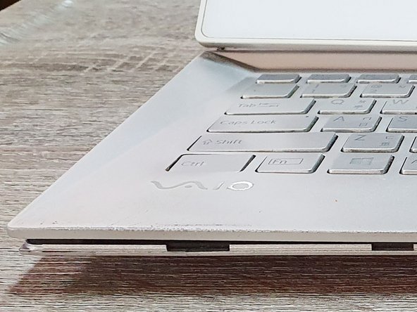

  1. Sony Vaio Duo 13 Battery Replacement, Check the appearance of the laptop before replacement: crwdns2935265:01crwdnd2935265:01crwdnd2935265:02crwdne2935265:0 Sony Vaio Duo 13 Battery Replacement, Check the appearance of the laptop before replacement: crwdns2935265:01crwdnd2935265:02crwdnd2935265:02crwdne2935265:0
    • Please check the appearance before fixing the laptop. For example: The laptop has been spread by the battery inside (up to 5 mm).

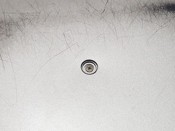

  3. Sony Vaio Duo 13 Battery Replacement, Teardown the laptop until the Li-ion battery appears: crwdns2935265:03crwdnd2935265:01crwdnd2935265:03crwdne2935265:0 Sony Vaio Duo 13 Battery Replacement, Teardown the laptop until the Li-ion battery appears: crwdns2935265:03crwdnd2935265:02crwdnd2935265:03crwdne2935265:0 Sony Vaio Duo 13 Battery Replacement, Teardown the laptop until the Li-ion battery appears: crwdns2935265:03crwdnd2935265:03crwdnd2935265:03crwdne2935265:0
    • Go to the back side of the laptop.
    • Remove the screw with a "+" screwdriver (the red circle).
    • Number of screws: 1

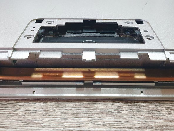

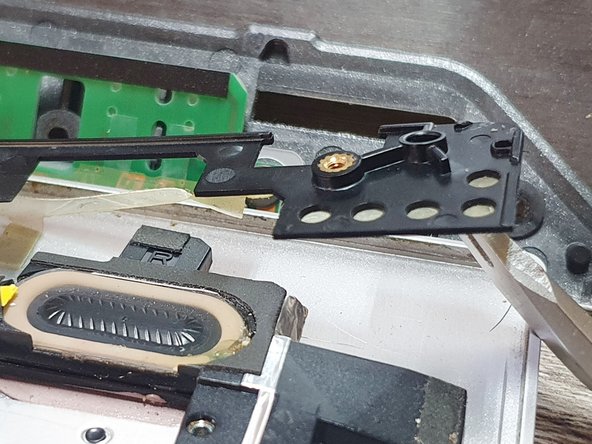

  5. Sony Vaio Duo 13 Battery Replacement: crwdns2935265:05crwdnd2935265:01crwdnd2935265:02crwdne2935265:0 Sony Vaio Duo 13 Battery Replacement: crwdns2935265:05crwdnd2935265:02crwdnd2935265:02crwdne2935265:0
    • Lever the plastic part by crowbar gently.
    • Suggested tools: (1) Crowbar, (2) "-" screwdriver.

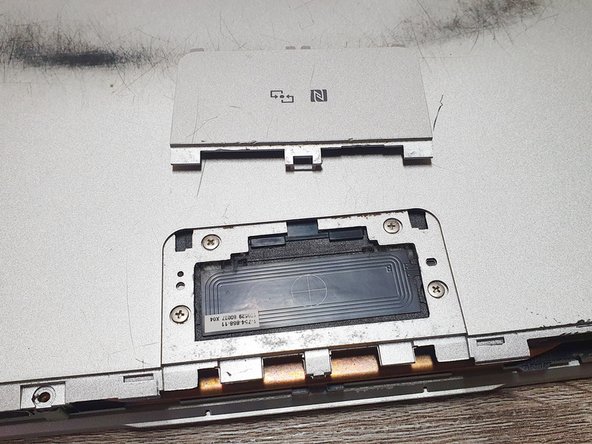

  7. Sony Vaio Duo 13 Battery Replacement: crwdns2935265:07crwdnd2935265:01crwdnd2935265:03crwdne2935265:0 Sony Vaio Duo 13 Battery Replacement: crwdns2935265:07crwdnd2935265:02crwdnd2935265:03crwdne2935265:0 Sony Vaio Duo 13 Battery Replacement: crwdns2935265:07crwdnd2935265:03crwdnd2935265:03crwdne2935265:0
    • Remove the "NFC cover" with a lever gently. Do not break the retaining buckle.
    • Suggested tools: (1) fingernail, (2) "-" screwdriver.
    • NOTE: Do not break the retaining buckle.

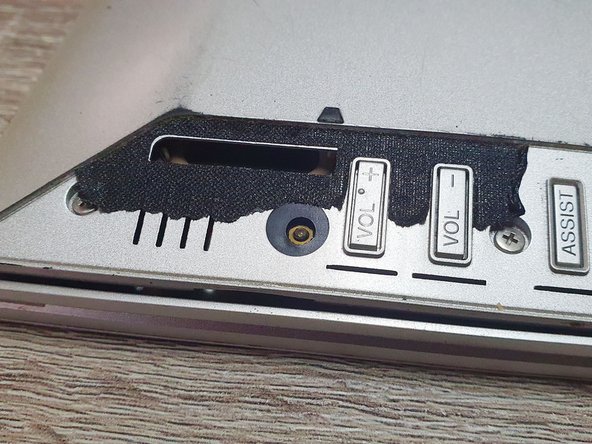

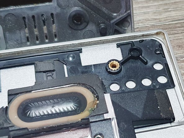

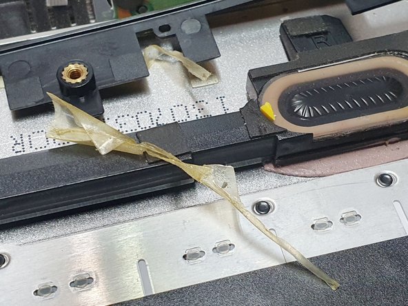

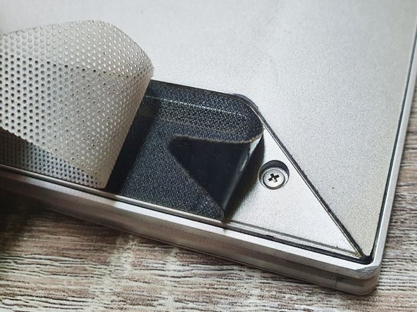

  9. Sony Vaio Duo 13 Battery Replacement: crwdns2935265:09crwdnd2935265:01crwdnd2935265:03crwdne2935265:0 Sony Vaio Duo 13 Battery Replacement: crwdns2935265:09crwdnd2935265:02crwdnd2935265:03crwdne2935265:0 Sony Vaio Duo 13 Battery Replacement: crwdns2935265:09crwdnd2935265:03crwdnd2935265:03crwdne2935265:0
    • Rotate the laptop 180°.
    • Tear off the plastic sheet (silver) and double-sided tape (black). The main thing is to let the screws hidden underneath show up.
    • NOTE: It is difficult to remove the double-sided tape completely, and some remain on the surface, but it does not affect entire the repair process.
    • CAUTION: This step is a "destructive" teardown and cannot be restored to its original state.

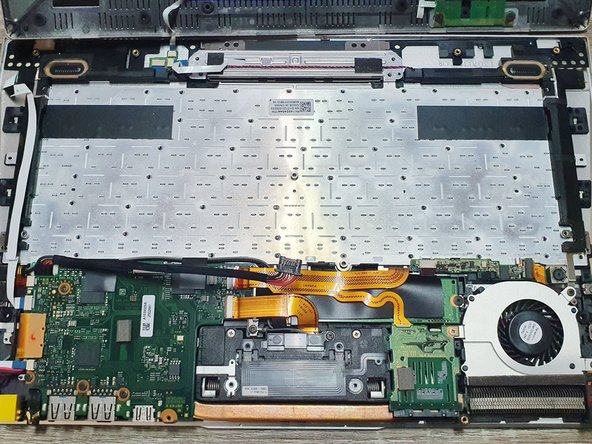

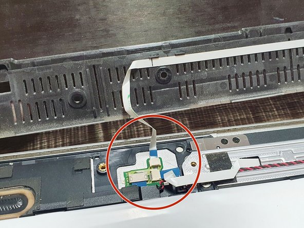

  11. Sony Vaio Duo 13 Battery Replacement, Open the back side of the laptop: crwdns2935265:011crwdnd2935265:01crwdnd2935265:03crwdne2935265:0 Sony Vaio Duo 13 Battery Replacement, Open the back side of the laptop: crwdns2935265:011crwdnd2935265:02crwdnd2935265:03crwdne2935265:0 Sony Vaio Duo 13 Battery Replacement, Open the back side of the laptop: crwdns2935265:011crwdnd2935265:03crwdnd2935265:03crwdne2935265:0
    • Follow the direction of the red arrow and open the backside of the laptop from the open side, where the cooling cooper tube can be obviously been seen.
    • The swollen Li-ion battery appears (the white package).
    • CAUTION: If the backside is opened from other directions, the flat cable may be broken or the plug may be damaged (the red circle).
  12. Sony Vaio Duo 13 Battery Replacement, Remove the old or damaged Li-ion battery: crwdns2935265:012crwdnd2935265:01crwdnd2935265:02crwdne2935265:0 Sony Vaio Duo 13 Battery Replacement, Remove the old or damaged Li-ion battery: crwdns2935265:012crwdnd2935265:02crwdnd2935265:02crwdne2935265:0
    • Remove the screws with a "+" screwdriver (red circles).
    • Number of screws: 7
    • NOTE: Please avoid flat cables when removing screws. For example: see the red box.
    • CAUTION: Don't damage the Li-ion battery or something bad will happen, such as gas leakage, electrolyte leakage, fire, and explosion. REF: https://doi.org/10.31224/osf.io/swcyg
  13. Sony Vaio Duo 13 Battery Replacement: crwdns2935265:013crwdnd2935265:01crwdnd2935265:03crwdne2935265:0 Sony Vaio Duo 13 Battery Replacement: crwdns2935265:013crwdnd2935265:02crwdnd2935265:03crwdne2935265:0 Sony Vaio Duo 13 Battery Replacement: crwdns2935265:013crwdnd2935265:03crwdnd2935265:03crwdne2935265:0
    • Lift the Li-ion battery gently.
    • Pull out the flat cable gently and then remove the Li-ion battery completely.
    • Background: About the flat cable. Generally speaking, the red thick line is the "+" power line; the black thick line is the "-" power line; other thin lines are signal lines.

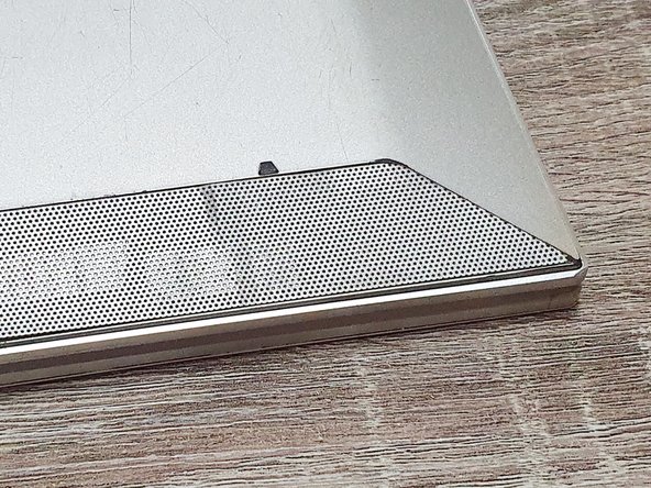

  14. Sony Vaio Duo 13 Battery Replacement, Replace the old double-sided tapes (optional): crwdns2935265:014crwdnd2935265:01crwdnd2935265:03crwdne2935265:0 Sony Vaio Duo 13 Battery Replacement, Replace the old double-sided tapes (optional): crwdns2935265:014crwdnd2935265:02crwdnd2935265:03crwdne2935265:0 Sony Vaio Duo 13 Battery Replacement, Replace the old double-sided tapes (optional): crwdns2935265:014crwdnd2935265:03crwdnd2935265:03crwdne2935265:0
    • Condition: The double-sided tape of the plastic part is degummed and has lost its stickiness. The plastic part clearly leaves the surface.
    • Remove the double-sided tape that has lost its stickiness.
  15. Sony Vaio Duo 13 Battery Replacement: crwdns2935265:015crwdnd2935265:01crwdnd2935265:02crwdne2935265:0 Sony Vaio Duo 13 Battery Replacement: crwdns2935265:015crwdnd2935265:02crwdnd2935265:02crwdne2935265:0
    • Use new double-sided tape.
    • Paste the plastic part back to its original position.
    • Do the same on the other side if necessary.
    • Suggestion: Do the same on the other side even though the plastic part sticks right on the surface. Because the old double-sided tape might not provide sufficient stickiness.
    • Other methods: The epoxy AB glue can replace the double-sided tape.

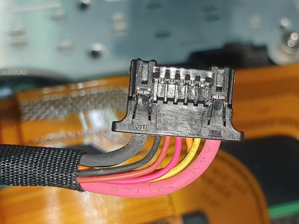

  16. Sony Vaio Duo 13 Battery Replacement, Install new Li-ion battery: crwdns2935265:016crwdnd2935265:01crwdnd2935265:02crwdne2935265:0 Sony Vaio Duo 13 Battery Replacement, Install new Li-ion battery: crwdns2935265:016crwdnd2935265:02crwdnd2935265:02crwdne2935265:0
    • Plug the cable into the new Li-ion battery gently and tightly.
    • To reassemble the laptop, follow steps 3~11 in reverse order. Some possible conditions and how to handle them will be described in the following steps.
    • NOTE: Make sure the cable is firmly inserted (the red box).
    • CAUTION: If the cable is not firmly inserted. Several worse conditions might happen. (1) Power failure (No electricity) and (2) Unstable connection cause an electric arc, fire, and explosion.
    • NOTE: Make sure the cable is securely fastened (red circles).
    • CAUTION: If the cable is not securely fastened. The cable might be squeezed by other parts, causing an unstable power supply and even safety issues (arc, fire, and explosion). REF: https://doi.org/10.31224/osf.io/swcyg

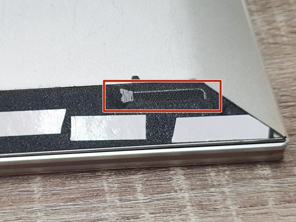

  17. Sony Vaio Duo 13 Battery Replacement, Stick back the plastic sheet and double-sided tape: crwdns2935265:017crwdnd2935265:01crwdnd2935265:03crwdne2935265:0 Sony Vaio Duo 13 Battery Replacement, Stick back the plastic sheet and double-sided tape: crwdns2935265:017crwdnd2935265:02crwdnd2935265:03crwdne2935265:0 Sony Vaio Duo 13 Battery Replacement, Stick back the plastic sheet and double-sided tape: crwdns2935265:017crwdnd2935265:03crwdnd2935265:03crwdne2935265:0
    • Condition: The stickiness of the old double-sided tape (black) is not sufficient to stick back the plastic sheet (silver).
    • Use new double-sided tape (white) to stick the plastic sheet and the old double-sided tape.
    • NOTE: The new double-sided tape should avoid the soundhole (red box).

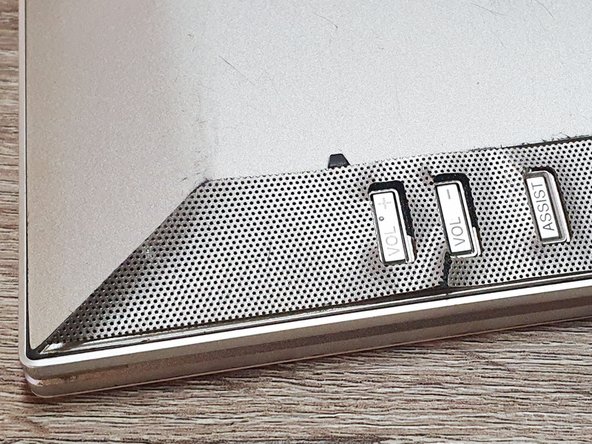

  18. Sony Vaio Duo 13 Battery Replacement: crwdns2935265:018crwdnd2935265:01crwdnd2935265:02crwdne2935265:0 Sony Vaio Duo 13 Battery Replacement: crwdns2935265:018crwdnd2935265:02crwdnd2935265:02crwdne2935265:0
    • Condition: The damaged plastic sheet (silver) is caused by the "destructive" teardown in step 9.
  19. Sony Vaio Duo 13 Battery Replacement, Spacing fixing (optional): crwdns2935265:019crwdnd2935265:01crwdnd2935265:02crwdne2935265:0 Sony Vaio Duo 13 Battery Replacement, Spacing fixing (optional): crwdns2935265:019crwdnd2935265:02crwdnd2935265:02crwdne2935265:0
    • Condition: If the stickiness of the double-sided tape is not sufficient, causing a spacing.
    • Suggested method: Repeat steps 14 and 15.
    • Other methods: Use tape to fix the problem. In this case, the yellow tapes are used for the clear demonstration. Users can use other color tapes.
