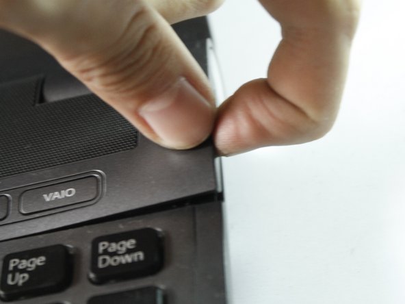

  4. Sony VAIO VPCF 132FX Power Button Replacement: crwdns2935265:04crwdnd2935265:01crwdnd2935265:03crwdne2935265:0 Sony VAIO VPCF 132FX Power Button Replacement: crwdns2935265:04crwdnd2935265:02crwdnd2935265:03crwdne2935265:0 Sony VAIO VPCF 132FX Power Button Replacement: crwdns2935265:04crwdnd2935265:03crwdnd2935265:03crwdne2935265:0
    • Lift the screen and slide your nail or any flat plastic to the side of the cover to unclip it.
    • Slide from the sides towards the center.

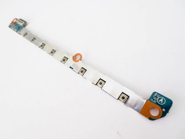

  7. Sony VAIO VPCF 132FX Power Button Replacement, Power Button: crwdns2935265:07crwdnd2935265:01crwdnd2935265:01crwdne2935265:0
    • Unscrew the Power button.
  8. Sony VAIO VPCF 132FX Power Button Replacement: crwdns2935265:08crwdnd2935265:01crwdnd2935265:03crwdne2935265:0 Sony VAIO VPCF 132FX Power Button Replacement: crwdns2935265:08crwdnd2935265:02crwdnd2935265:03crwdne2935265:0 Sony VAIO VPCF 132FX Power Button Replacement: crwdns2935265:08crwdnd2935265:03crwdnd2935265:03crwdne2935265:0
