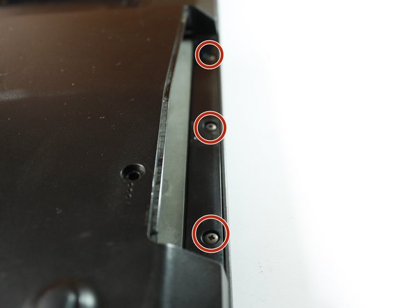

  11. Sony VAIO VPCF 132FX Bottom Case Replacement, Bottom Case: crwdns2935265:011crwdnd2935265:01crwdnd2935265:02crwdne2935265:0 Sony VAIO VPCF 132FX Bottom Case Replacement, Bottom Case: crwdns2935265:011crwdnd2935265:02crwdnd2935265:02crwdne2935265:0
    • Remove all the other screws.
    • Dont forget the 3 screws after you remove the CD/DVD Drive.
