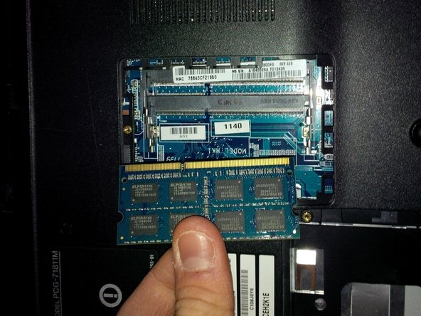

  3. Sony VAIO VPCEH2K1E Heat Sink Replacement: crwdns2935265:03crwdnd2935265:01crwdnd2935265:03crwdne2935265:0 Sony VAIO VPCEH2K1E Heat Sink Replacement: crwdns2935265:03crwdnd2935265:02crwdnd2935265:03crwdne2935265:0 Sony VAIO VPCEH2K1E Heat Sink Replacement: crwdns2935265:03crwdnd2935265:03crwdnd2935265:03crwdne2935265:0
    • now we will remove the RAM.
    • remove the plastic plate.
    • remove the RAM module.

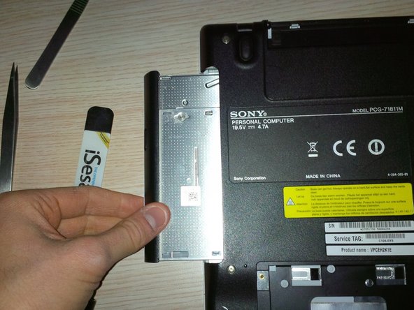

    • In this step we will remove the DVD/rw player.
    • remove the screw ( in the black plastic you'll see 3 dots in a row) i made a red circkle around it.
    • after removing the screw you can remove the DVD , using a spudger and slide it to the left.

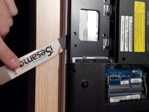

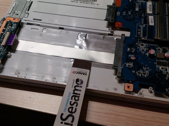

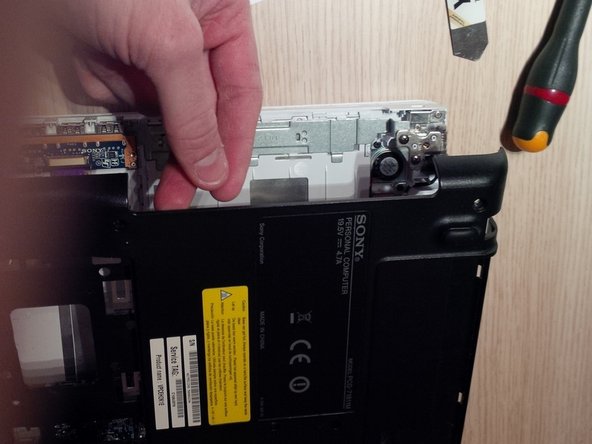

    • now, after removing all the screws, we wille open the bottom plate of the laptop.
    • use a spudger, or a spudger and the isesamo , to open the laptop. but be carefull
    • slide the spudger/isesamo, you will hear clicks ...
    • then , gently pull the bottomplate towards you. see picture 3

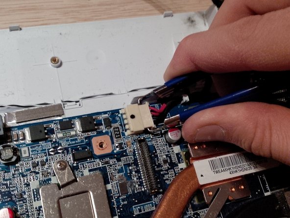

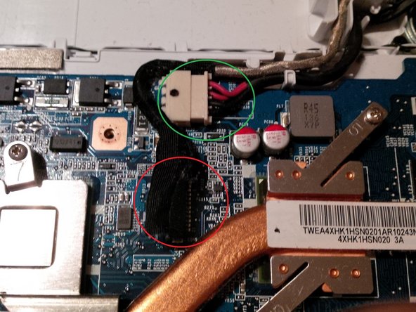

  8. Sony VAIO VPCEH2K1E Heat Sink Replacement: crwdns2935265:08crwdnd2935265:01crwdnd2935265:03crwdne2935265:0 Sony VAIO VPCEH2K1E Heat Sink Replacement: crwdns2935265:08crwdnd2935265:02crwdnd2935265:03crwdne2935265:0 Sony VAIO VPCEH2K1E Heat Sink Replacement: crwdns2935265:08crwdnd2935265:03crwdnd2935265:03crwdne2935265:0

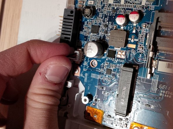

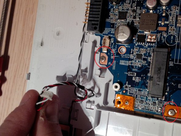

    • after removing the bottomplate you'll see the motherboard or mainboard ( in Belgium and the Netherlands we call it a motherboard.)
    • we will remove the connectors and cable's from the mainboard.
    • 2th picture : in green you'll see the DC jack power connector. gently remove it.
    • in the same picture you see the screen connector ( in red) gently remove it.
    • i used a special tweezer to remove the DC jack power cable connector. like you see in the 3th picture.

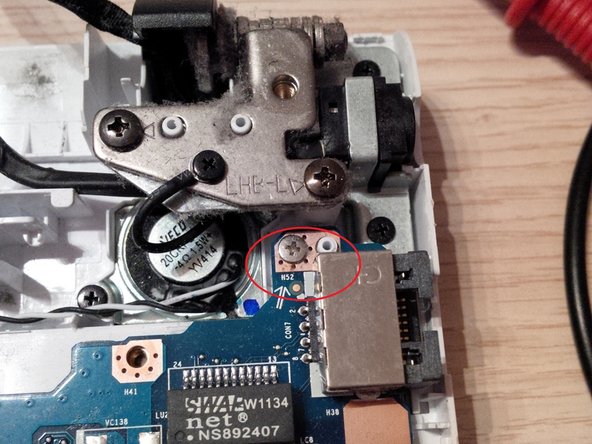

  9. Sony VAIO VPCEH2K1E Heat Sink Replacement: crwdns2935265:09crwdnd2935265:01crwdnd2935265:02crwdne2935265:0 Sony VAIO VPCEH2K1E Heat Sink Replacement: crwdns2935265:09crwdnd2935265:02crwdnd2935265:02crwdne2935265:0
    • now we will remove the wifi PCIe card and the cable's , together with the audio cable connector.
    • first remove the grey and black cable ( antenna's ) use just a flat screwdriver or spudger or... ( it will just click off..) circkled in red.
    • now remove the black screw , if you unscrew it, the pci e card will come towards you.
    • remove the card by pulling it out.
    • remove the audio cable's connector. i used a dentist picking tool. you can use a thick tweezer or a nose pliers ( small one).

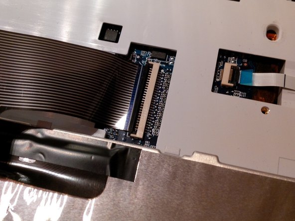

    • in this step we will remove the keyboard and the connector.
    • first use the isesamo to remove the keyboard by pulling it towards you ..
    • gently loosen up the connector. I use a dental picking tool to click the plastic holder up and then gently remove the cable.
    • the plastic clip (holder) is removable .. so watch out you dont loose it.

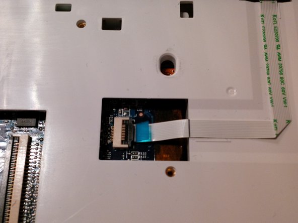

  11. Sony VAIO VPCEH2K1E Heat Sink Replacement: crwdns2935265:011crwdnd2935265:01crwdnd2935265:02crwdne2935265:0 Sony VAIO VPCEH2K1E Heat Sink Replacement: crwdns2935265:011crwdnd2935265:02crwdnd2935265:02crwdne2935265:0

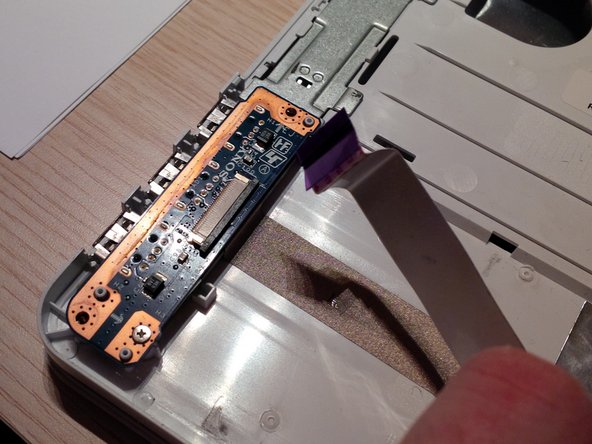

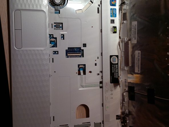

    • now remove ( gently) the other connectors of the mousepad and the poweboard (PCB)
    • as i said earlier, use a dental pick to loose the plastic holder of the connector.

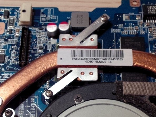

  14. Sony VAIO VPCEH2K1E Heat Sink Replacement: crwdns2935265:014crwdnd2935265:01crwdnd2935265:03crwdne2935265:0 Sony VAIO VPCEH2K1E Heat Sink Replacement: crwdns2935265:014crwdnd2935265:02crwdnd2935265:03crwdne2935265:0 Sony VAIO VPCEH2K1E Heat Sink Replacement: crwdns2935265:014crwdnd2935265:03crwdnd2935265:03crwdne2935265:0

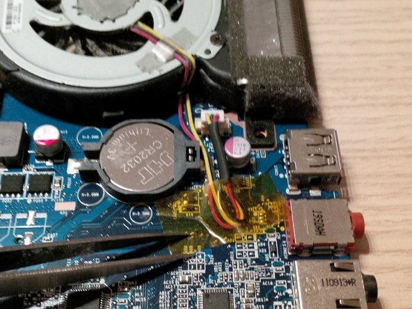

    • in this step we will remove the CPU cooler.
    • remove all the screws as shown in the picture.
    • only remove the screws of the coller , not the fan. (yet)
    • remove the yellow tape on the wires and mainboard.
    • unplug the connector, and remove the CPU cooler from the mainboard.
  15. Sony VAIO VPCEH2K1E Heat Sink Replacement: crwdns2935265:015crwdnd2935265:01crwdnd2935265:02crwdne2935265:0 Sony VAIO VPCEH2K1E Heat Sink Replacement: crwdns2935265:015crwdnd2935265:02crwdnd2935265:02crwdne2935265:0
    • after removing the CPU cooler, use a power duster ( air duster) to blow the dust out of the cooler.
    • my CPU cooler was broke ( a little plastic piece broke off...) so the computer was always rebooting cause the cpu could not cool down. ( you will see the plastic piece in the first picture.)
