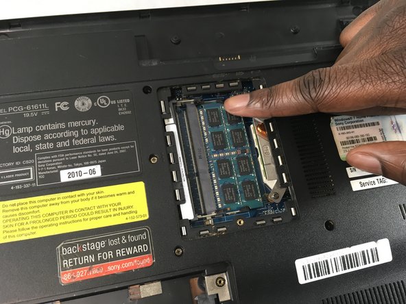

    1. Sony VAIO VPCEE26FX RAM Replacement, RAM: crwdns2935265:03crwdnd2935265:01crwdnd2935265:01crwdne2935265:0
      • Using a JIS #0 screwdriver, loosen the captive screw attached to the RAM cover.
      • This screw will not come out all the way, but will remain attached to the cover instead.
    2. Sony VAIO VPCEE26FX RAM Replacement: crwdns2935265:04crwdnd2935265:01crwdnd2935265:01crwdne2935265:0
      • Remove the cover which will reveal the two RAM sticks.
    3. Sony VAIO VPCEE26FX RAM Replacement: crwdns2935265:05crwdnd2935265:01crwdnd2935265:03crwdne2935265:0 Sony VAIO VPCEE26FX RAM Replacement: crwdns2935265:05crwdnd2935265:02crwdnd2935265:03crwdne2935265:0 Sony VAIO VPCEE26FX RAM Replacement: crwdns2935265:05crwdnd2935265:03crwdnd2935265:03crwdne2935265:0
      • Push the two tabs holding the RAM sticks in place, away from each other.
      • The first RAM stick will pop up out of place. Remove it away from its position.
    4. Sony VAIO VPCEE26FX RAM Replacement: crwdns2935265:06crwdnd2935265:01crwdnd2935265:03crwdne2935265:0 Sony VAIO VPCEE26FX RAM Replacement: crwdns2935265:06crwdnd2935265:02crwdnd2935265:03crwdne2935265:0 Sony VAIO VPCEE26FX RAM Replacement: crwdns2935265:06crwdnd2935265:03crwdnd2935265:03crwdne2935265:0
      • Push the two tabs holding the second RAM stick in, away from each other.
      • The second RAM stick will pop up out of place. Remove it away from its position.
