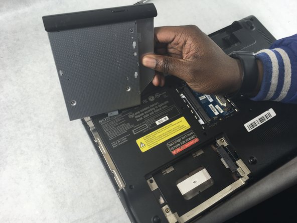

    1. Sony VAIO VPCEE26FX Optical Drive Replacement, Optical Drive: crwdns2935265:03crwdnd2935265:01crwdnd2935265:01crwdne2935265:0
      • Use a JIS #0 screwdriver to remove the 4mm screw from its place.
    2. Sony VAIO VPCEE26FX Optical Drive Replacement: crwdns2935265:04crwdnd2935265:01crwdnd2935265:02crwdne2935265:0 Sony VAIO VPCEE26FX Optical Drive Replacement: crwdns2935265:04crwdnd2935265:02crwdnd2935265:02crwdne2935265:0
      • Remove the optical drive gently away from its holder on the laptop.
