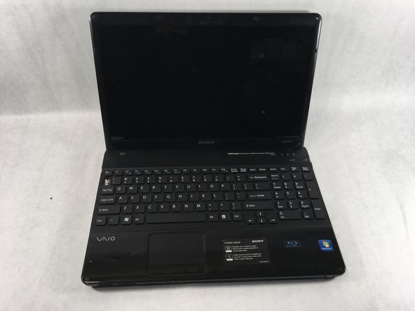

    1. Sony VAIO VPCEE26FX Keyboard Replacement, Keyboard: crwdns2935265:03crwdnd2935265:01crwdnd2935265:02crwdne2935265:0 Sony VAIO VPCEE26FX Keyboard Replacement, Keyboard: crwdns2935265:03crwdnd2935265:02crwdnd2935265:02crwdne2935265:0
      • Flip the laptop back over so it is face up.
      • Open up the laptop.
    2. Sony VAIO VPCEE26FX Keyboard Replacement: crwdns2935265:04crwdnd2935265:01crwdnd2935265:01crwdne2935265:0
      • Using a plastic opening tool, pry along the seam between the keyboard and case to help in separating the two.
      • Continue to lift up gently using the plastic opening tool until the keyboard begins to separate from the case.

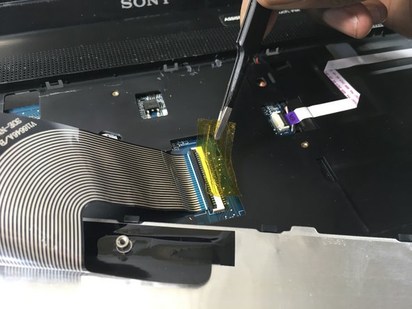

    4. Sony VAIO VPCEE26FX Keyboard Replacement: crwdns2935265:06crwdnd2935265:01crwdnd2935265:02crwdne2935265:0 Sony VAIO VPCEE26FX Keyboard Replacement: crwdns2935265:06crwdnd2935265:02crwdnd2935265:02crwdne2935265:0
      • Carefully tilt the top of the keyboard towards you ensuring the ribbon cable is not under too much tension.
      • Use a pair of tweezers to help remove the plastic adhesive film covering the adapter/port for the ribbon cable.
    5. Sony VAIO VPCEE26FX Keyboard Replacement: crwdns2935265:07crwdnd2935265:01crwdnd2935265:01crwdne2935265:0
    6. Sony VAIO VPCEE26FX Keyboard Replacement: crwdns2935265:08crwdnd2935265:01crwdnd2935265:01crwdne2935265:0
      • Lift the keyboard up and away from the computer.
