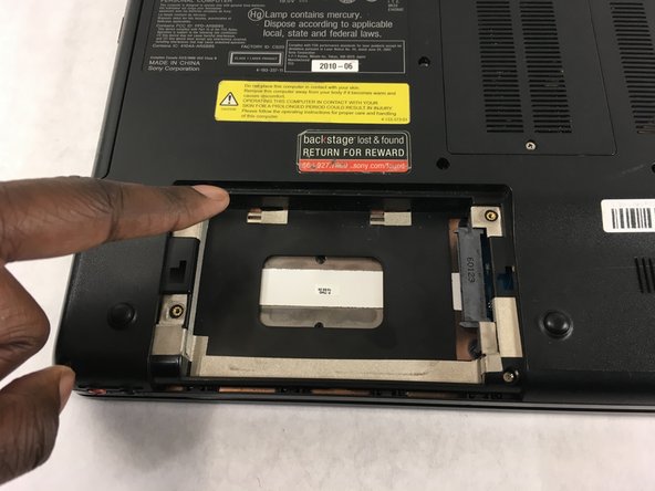

  3. Sony VAIO VPCEE26FX Hard Disk Drive Replacement, Hard Disk Drive: crwdns2935265:03crwdnd2935265:01crwdnd2935265:02crwdne2935265:0 Sony VAIO VPCEE26FX Hard Disk Drive Replacement, Hard Disk Drive: crwdns2935265:03crwdnd2935265:02crwdnd2935265:02crwdne2935265:0
    • Using a JIS #0 screwdriver, remove the two 4mm screws securing the hard drive cover to the laptop.
    • Lift the hard drive up and out of its place.
    • The drive cover and hard drive are not pictured. They are both missing from this particular device.
