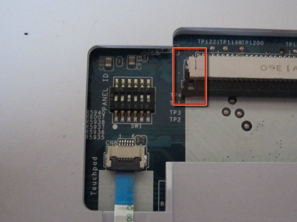

      • Flip up the retaining flap (highlighted in red) on the keyboard ribbon cable ZIF socket.
      • Be sure you are prying up on the hinged retaining flap and not the socket itself.
      • Pull the keyboard ribbon cable straight out of its socket toward the front edge of the laptop.
