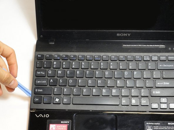

    • Start to pry out the keyboard with your hands.
    • Be careful not to break any of the hooks that attach the keyboard to the laptop.
    • If it seems difficult to remove the keyboard with your hands, then use a plastic opening tool.
  19. Sony VAIO VPC-EB33FM Display Replacement: crwdns2935265:019crwdnd2935265:01crwdnd2935265:02crwdne2935265:0 Sony VAIO VPC-EB33FM Display Replacement: crwdns2935265:019crwdnd2935265:02crwdnd2935265:02crwdne2935265:0
    • Remain cautious to not break the hooks.
    • Continue all the way around the keyboard until you can detach it from the laptop.

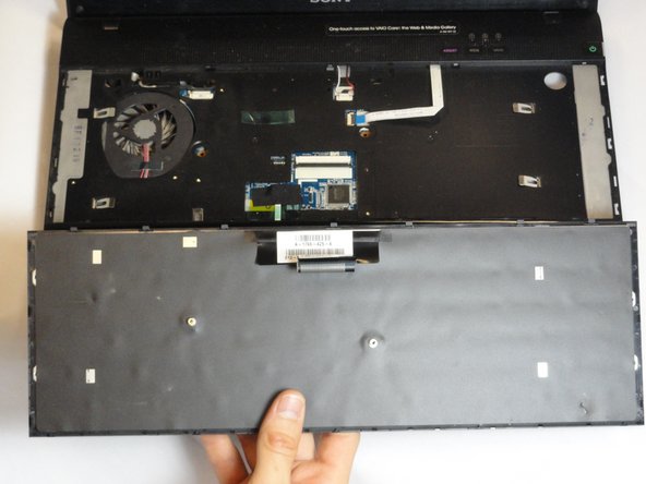

  20. Sony VAIO VPC-EB33FM Display Replacement: crwdns2935265:020crwdnd2935265:01crwdnd2935265:02crwdne2935265:0 Sony VAIO VPC-EB33FM Display Replacement: crwdns2935265:020crwdnd2935265:02crwdnd2935265:02crwdne2935265:0

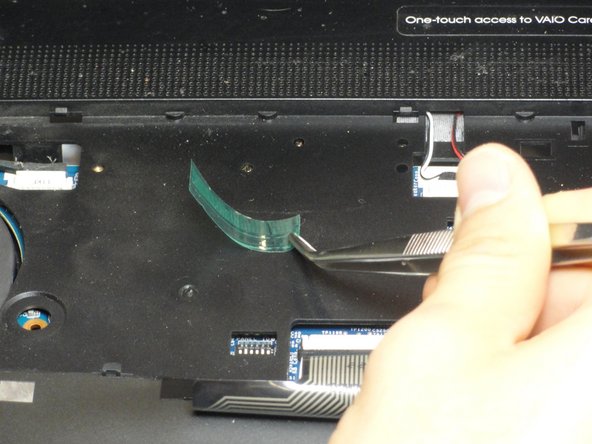

    • Do not immediately pull the keyboard away from the laptop. There is still an attachment between the keyboard and laptop.
    • Turn the keyboard on its face and locate the green tape and the ribbon attachment.
    • Using the metal tweezer, remove only the green sticker.
    • Place the sticker at any location as long as you remember to use it for installing the keyboard.
  21. Sony VAIO VPC-EB33FM Display Replacement: crwdns2935265:021crwdnd2935265:01crwdnd2935265:02crwdne2935265:0 Sony VAIO VPC-EB33FM Display Replacement: crwdns2935265:021crwdnd2935265:02crwdnd2935265:02crwdne2935265:0
    • Locate the black retaining arms.
    • Using the plastic opening tool, pull the retaining arms out.
    • The retaining arms will not come off completely.
  22. Sony VAIO VPC-EB33FM Display Replacement: crwdns2935265:022crwdnd2935265:01crwdnd2935265:02crwdne2935265:0 Sony VAIO VPC-EB33FM Display Replacement: crwdns2935265:022crwdnd2935265:02crwdnd2935265:02crwdne2935265:0
    • It is safe to touch the ribbon attachment.
    • Lift the retaining arms with the plastic opening tool at an angle so that the ribbon attachment can be pulled out.

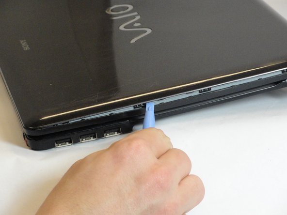

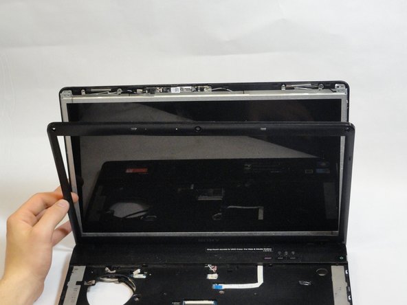

    • Use the plastic opening tool to separate the plastic front cover by wedging the tool along the seam.
    • Flip the laptop to the other side. If the front cover is still attached continue using the plastic opening tool to separate.
    • Carefully lift up the display. Completely detach the front plastic cover.
  29. Sony VAIO VPC-EB33FM Display Replacement: crwdns2935265:029crwdnd2935265:01crwdnd2935265:01crwdne2935265:0
    • Use a Phillips #00 screwdriver to remove the four 5.65-mm screws on each bottom corner of the display.

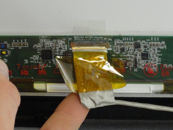

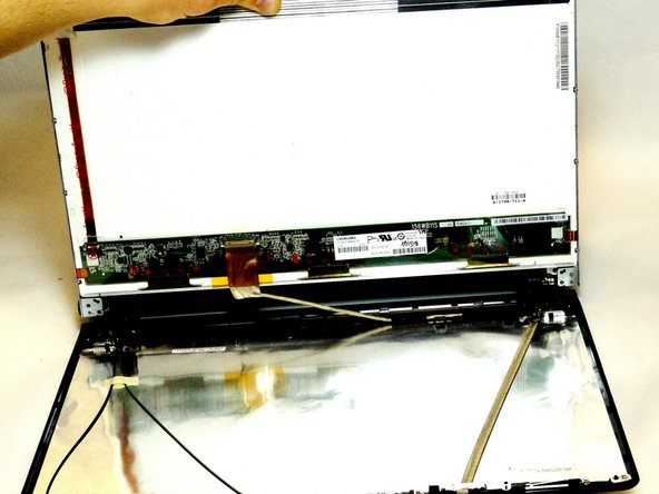

  30. Sony VAIO VPC-EB33FM Display Replacement: crwdns2935265:030crwdnd2935265:01crwdnd2935265:03crwdne2935265:0 Sony VAIO VPC-EB33FM Display Replacement: crwdns2935265:030crwdnd2935265:02crwdnd2935265:03crwdne2935265:0 Sony VAIO VPC-EB33FM Display Replacement: crwdns2935265:030crwdnd2935265:03crwdnd2935265:03crwdne2935265:0
    • Do not pull too hard to avoid damage to the connections.
    • Gently lift and pull the LCD screen up. The back of the screen has a connection attached by yellow tape.
    • Holding the silver flap underneath the yellow tape, pull up and disconnect the wire.
    • Place the LCD screen aside.

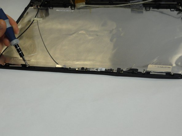

    • Use a Phillips #00 screwdriver to remove the four 3.15-mm screws at top of the display.
  33. Sony VAIO VPC-EB33FM Display Replacement: crwdns2935265:033crwdnd2935265:01crwdnd2935265:03crwdne2935265:0 Sony VAIO VPC-EB33FM Display Replacement: crwdns2935265:033crwdnd2935265:02crwdnd2935265:03crwdne2935265:0 Sony VAIO VPC-EB33FM Display Replacement: crwdns2935265:033crwdnd2935265:03crwdnd2935265:03crwdne2935265:0

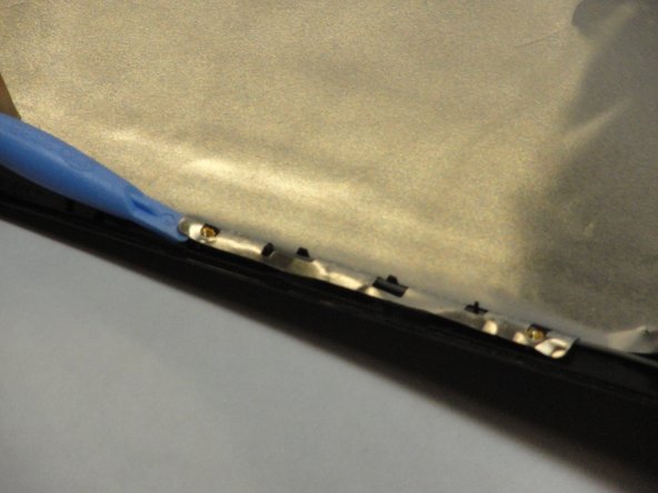

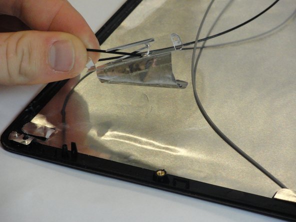

    • Use the plastic opening tool to gently fold back all metal flaps at the beginnings and ends of wires.
    • Remove the tape holding a thin black and gray wire in place.
  34. Sony VAIO VPC-EB33FM Display Replacement: crwdns2935265:034crwdnd2935265:01crwdnd2935265:01crwdne2935265:0
    • Use a plastic opening tool to loosen and remove the two connections at the top end of the wire with a thick silver covering.
    • Metal tweezers may also be used to remove the connections.
  35. Sony VAIO VPC-EB33FM Display Replacement: crwdns2935265:035crwdnd2935265:01crwdnd2935265:02crwdne2935265:0 Sony VAIO VPC-EB33FM Display Replacement: crwdns2935265:035crwdnd2935265:02crwdnd2935265:02crwdne2935265:0

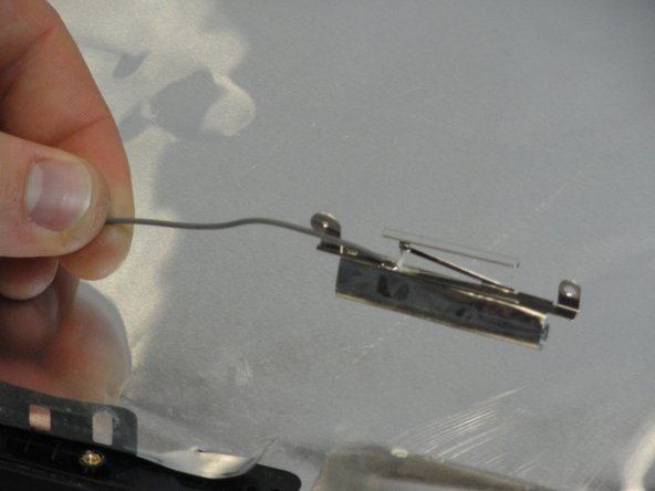

    • Carefully pull the webcam and to remove it.
    • Fold back the metal flap under the webcam with the plastic opening tool.

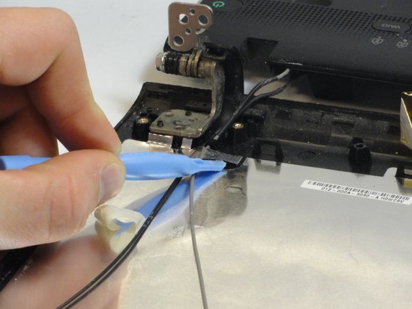

  36. Sony VAIO VPC-EB33FM Display Replacement: crwdns2935265:036crwdnd2935265:01crwdnd2935265:02crwdne2935265:0 Sony VAIO VPC-EB33FM Display Replacement: crwdns2935265:036crwdnd2935265:02crwdnd2935265:02crwdne2935265:0

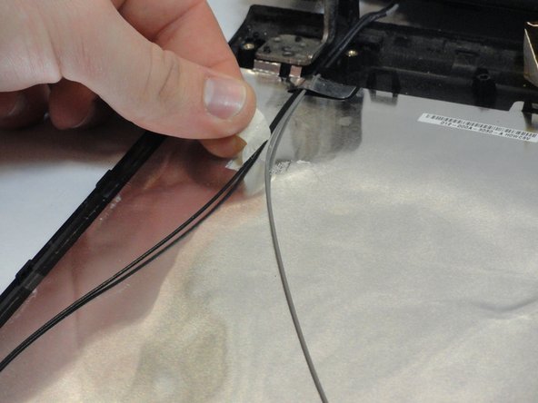

    • Pull back the silver tape attaching the gray wire.
  37. Sony VAIO VPC-EB33FM Display Replacement: crwdns2935265:037crwdnd2935265:01crwdnd2935265:02crwdne2935265:0 Sony VAIO VPC-EB33FM Display Replacement: crwdns2935265:037crwdnd2935265:02crwdnd2935265:02crwdne2935265:0
    • Pull back the silver tape attaching the black wire
  38. Sony VAIO VPC-EB33FM Display Replacement: crwdns2935265:038crwdnd2935265:01crwdnd2935265:01crwdne2935265:0
