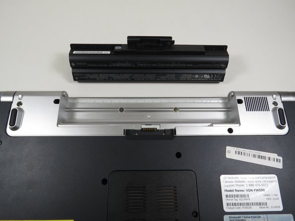

    • Turn the computer off, close the LCD screen, and insure the computer is unplugged from any outlet.
    • Turn the computer over so that the bottom of the computer is facing up and the "screen swivels" (DC in port and On button) are facing away from you.
    • Locate the battery pack between the two "screen swivels" at the top of the computer back.
  2. Sony VAIO VGN-FW 590 Keyboard Replacement: crwdns2935265:02crwdnd2935265:01crwdnd2935265:02crwdne2935265:0 Sony VAIO VGN-FW 590 Keyboard Replacement: crwdns2935265:02crwdnd2935265:02crwdnd2935265:02crwdne2935265:0
    • Locate two sliding release switches below the battery pack.
    • Slide the "Lock" release to the right toward the center of the computer.
    • Slide the "Release" switch to the left, toward the center of the computer. It must be held in place because it is spring loaded.
  3. Sony VAIO VGN-FW 590 Keyboard Replacement: crwdns2935265:03crwdnd2935265:01crwdnd2935265:02crwdne2935265:0 Sony VAIO VGN-FW 590 Keyboard Replacement: crwdns2935265:03crwdnd2935265:02crwdnd2935265:02crwdne2935265:0
    • While holding the "Release" switch toward the center of the computer, press on the raised portion of the battery pack away from you. The battery pack will pop up.
    • Once the battery pack has popped out of its compartment, lift it out of the computer.

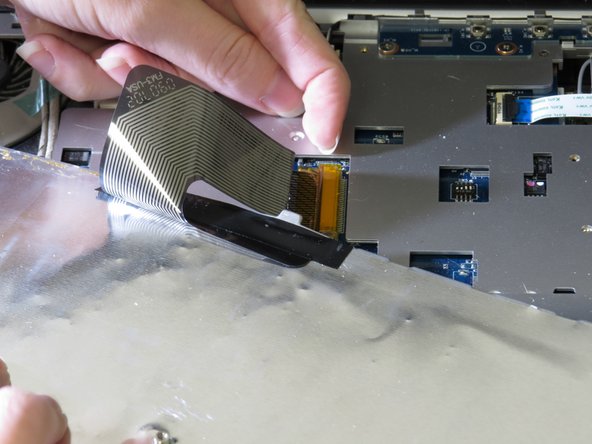

  7. Sony VAIO VGN-FW 590 Keyboard Replacement: crwdns2935265:07crwdnd2935265:01crwdnd2935265:01crwdne2935265:0
    • Lift the keyboard gently, starting with one of the top corners.
    • Pull keyboard gently from body of computer to prevent warping or breakage.
    • Caution Do not remove completely.
  8. Sony VAIO VGN-FW 590 Keyboard Replacement: crwdns2935265:08crwdnd2935265:01crwdnd2935265:03crwdne2935265:0 Sony VAIO VGN-FW 590 Keyboard Replacement: crwdns2935265:08crwdnd2935265:02crwdnd2935265:03crwdne2935265:0 Sony VAIO VGN-FW 590 Keyboard Replacement: crwdns2935265:08crwdnd2935265:03crwdnd2935265:03crwdne2935265:0

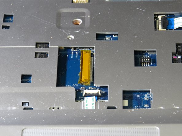

    • Locate the connector ribbon behind the keyboard.
    • Gently pull the ribbon from the locking device. It may take a few tries.
    • Caution Do not tear the ribbon.
