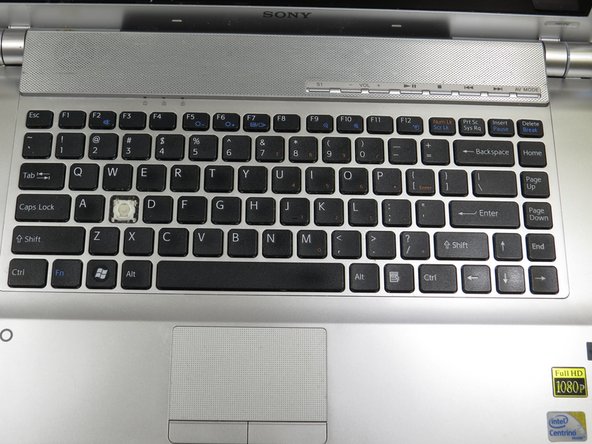

    • Open your computer.
    • Make sure the computer is turned off.
  2. Sony VAIO VGN-FW 590 Keyboard Key Replacement: crwdns2935265:02crwdnd2935265:01crwdnd2935265:01crwdne2935265:0
    • Find the broken key.
    • The S key is our example though it is not broken.
  3. Sony VAIO VGN-FW 590 Keyboard Key Replacement: crwdns2935265:03crwdnd2935265:01crwdnd2935265:02crwdne2935265:0 Sony VAIO VGN-FW 590 Keyboard Key Replacement: crwdns2935265:03crwdnd2935265:02crwdnd2935265:02crwdne2935265:0
    • Insert the plastic spudger underneath the edge of the key.
    • Lift the key until it pops off on all four corners. There should be a white plastic base underneath the key.
  4. Sony VAIO VGN-FW 590 Keyboard Key Replacement: crwdns2935265:04crwdnd2935265:01crwdnd2935265:01crwdne2935265:0
    • Orient replacement key over the white plastic base, so it is aligned properly with the other keys.
    • Press the replacement key firmly in the center until it is completely depressed and attached to the key base.
  5. Sony VAIO VGN-FW 590 Keyboard Key Replacement: crwdns2935265:05crwdnd2935265:01crwdnd2935265:01crwdne2935265:0
    • Test the key by releasing the key. It should pop up and look like the rest of the keys on the keyboard.
Congratulations! You have successfully replaced a key on your keyboard.
