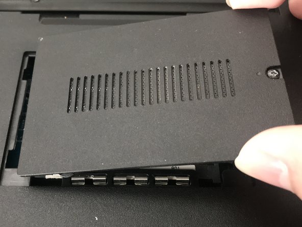

  2. Sony VAIO SVE171C11L RAM Replacement: crwdns2935265:02crwdnd2935265:01crwdnd2935265:01crwdne2935265:0

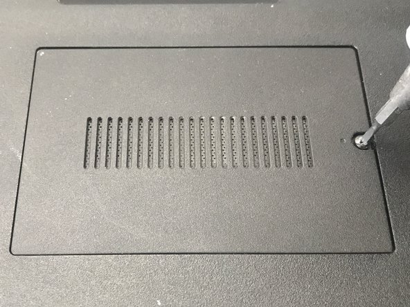

    • Flip the laptop over so the label on the bottom side is right side up.
    • Locate the panel near the middle of the laptop with grates and a single screw.
  3. Sony VAIO SVE171C11L RAM Replacement: crwdns2935265:03crwdnd2935265:01crwdnd2935265:02crwdne2935265:0 Sony VAIO SVE171C11L RAM Replacement: crwdns2935265:03crwdnd2935265:02crwdnd2935265:02crwdne2935265:0

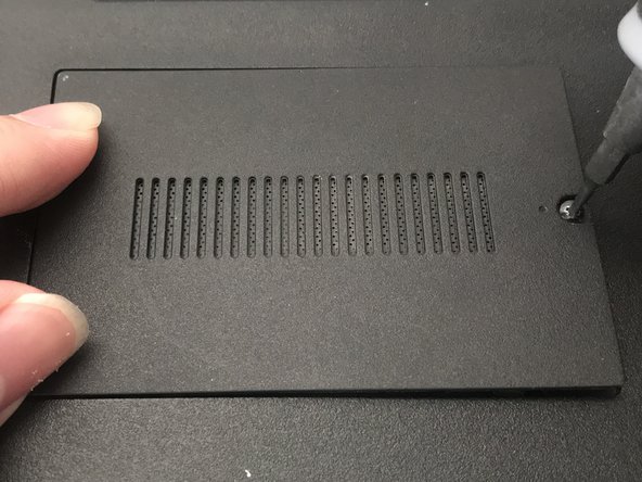

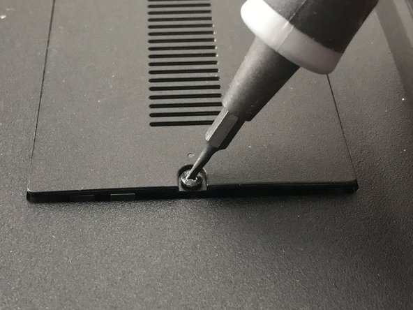

    • Use a 1.5 mm flathead screwdriver to turn the screw until the panel begins to pop off.
    • Once the side of the panel with the screw is no longer being held down, stop. Make sure to not remove the screw.
  4. Sony VAIO SVE171C11L RAM Replacement: crwdns2935265:04crwdnd2935265:01crwdnd2935265:03crwdne2935265:0 Sony VAIO SVE171C11L RAM Replacement: crwdns2935265:04crwdnd2935265:02crwdnd2935265:03crwdne2935265:0 Sony VAIO SVE171C11L RAM Replacement: crwdns2935265:04crwdnd2935265:03crwdnd2935265:03crwdne2935265:0

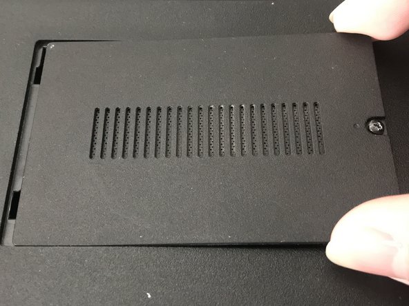

    • Carefully pull the loose end of the panel up until it pops up, but do not try to remove yet.
    • Slide the panel to the right until the hinges show.
    • Lift the panel up to remove it.

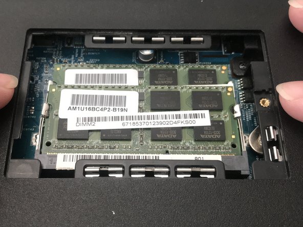

  5. Sony VAIO SVE171C11L RAM Replacement: crwdns2935265:05crwdnd2935265:01crwdnd2935265:03crwdne2935265:0 Sony VAIO SVE171C11L RAM Replacement: crwdns2935265:05crwdnd2935265:02crwdnd2935265:03crwdne2935265:0 Sony VAIO SVE171C11L RAM Replacement: crwdns2935265:05crwdnd2935265:03crwdnd2935265:03crwdne2935265:0

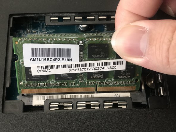

    • Choose which RAM you wish to replace.
    • Move the pins holding the RAM outwards and the RAM will pop up.
    • Carefully slide the RAM out to remove. Make sure to hold the RAM by its edges, never by its electrical components.
    • Repeat this step if you want to replace the second RAM that is behind the first.
  6. Sony VAIO SVE171C11L RAM Replacement: crwdns2935265:06crwdnd2935265:01crwdnd2935265:03crwdne2935265:0 Sony VAIO SVE171C11L RAM Replacement: crwdns2935265:06crwdnd2935265:02crwdnd2935265:03crwdne2935265:0 Sony VAIO SVE171C11L RAM Replacement: crwdns2935265:06crwdnd2935265:03crwdnd2935265:03crwdne2935265:0

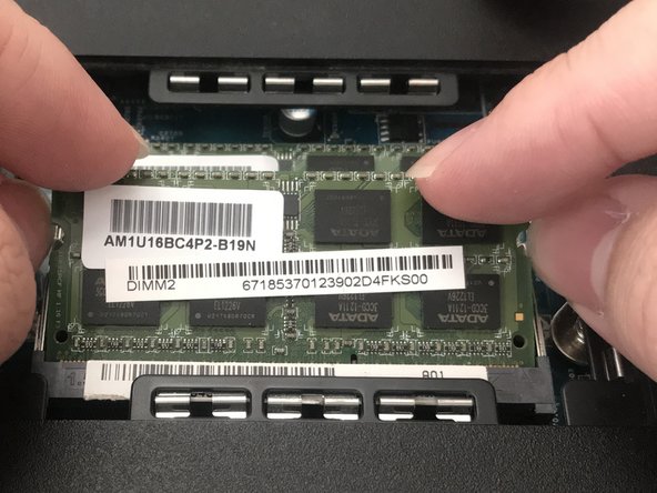

    • Push the new RAM into the slot marked with silver stripes.
    • Once pushed in, it will stand on its own and be secured in place.
    • Move the pins outward and push the RAM downwards past the pins.
    • Release the pins and move them over the RAM.
  7. Sony VAIO SVE171C11L RAM Replacement: crwdns2935265:07crwdnd2935265:01crwdnd2935265:03crwdne2935265:0 Sony VAIO SVE171C11L RAM Replacement: crwdns2935265:07crwdnd2935265:02crwdnd2935265:03crwdne2935265:0 Sony VAIO SVE171C11L RAM Replacement: crwdns2935265:07crwdnd2935265:03crwdnd2935265:03crwdne2935265:0
    • Slide the panel hinge back into place.
    • Push down on the panel so it pops into place.
    • Screw the panel clockwise back on while pushing the panel downwards.
    • Continue to turn until the screw tightens in place.
