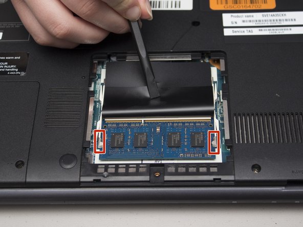

  3. Sony VAIO SVE14AJ16L RAM Replacement: crwdns2935265:03crwdnd2935265:01crwdnd2935265:03crwdne2935265:0 Sony VAIO SVE14AJ16L RAM Replacement: crwdns2935265:03crwdnd2935265:02crwdnd2935265:03crwdne2935265:0 Sony VAIO SVE14AJ16L RAM Replacement: crwdns2935265:03crwdnd2935265:03crwdnd2935265:03crwdne2935265:0
    iFixit Opening Tool
    $1.99
    • With the cover removed, peel back the black protective plastic to expose one of the two RAM sticks.
    • Make sure not to touch any part of the blue board itself, and only handle the stick from it's edges.
    • Gently, but firmly push back the two side anchors that hold in the RAM using either an iFixit Opening Tool or your fingernails.

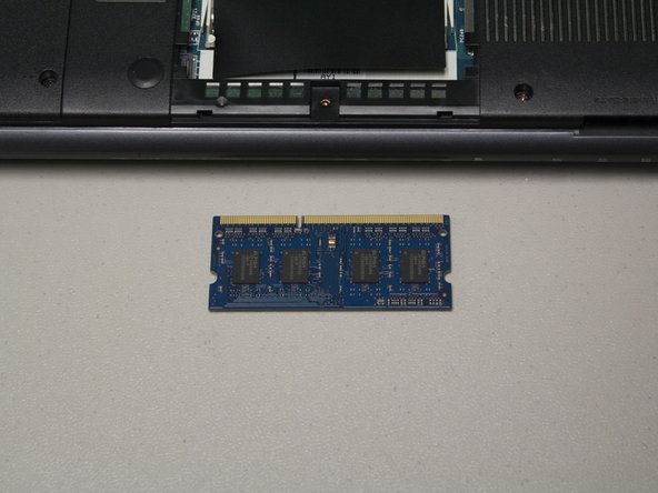

  4. Sony VAIO SVE14AJ16L RAM Replacement: crwdns2935265:04crwdnd2935265:01crwdnd2935265:02crwdne2935265:0 Sony VAIO SVE14AJ16L RAM Replacement: crwdns2935265:04crwdnd2935265:02crwdnd2935265:02crwdne2935265:0
    • Once both anchors are released from the RAM stick, the stick will spring up at an angle
    • Finally, carefully pull the RAM stick away from the laptop at the same angle it is sitting at.
