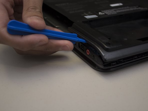

    • Remove the 13 Phillips #0 screws.
    • Make sure you have an organization system to remember which screws go where, as the majority are different sizes! The iFixit Magnetic Project Mat is an awesome tool for this exact reason!
    • Carefully pry apart the clipped-on bottom panel of the laptop to expose the internal of the laptop using the iFixit opening tool.

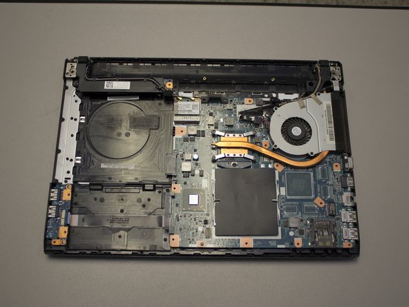

  4. Sony VAIO SVE14AJ16L I/O Card Replacement: crwdns2935265:04crwdnd2935265:01crwdnd2935265:01crwdne2935265:0
    • Locate the I/O card in the bottom left hand corner of the case.
  5. Sony VAIO SVE14AJ16L I/O Card Replacement: crwdns2935265:05crwdnd2935265:01crwdnd2935265:03crwdne2935265:0 Sony VAIO SVE14AJ16L I/O Card Replacement: crwdns2935265:05crwdnd2935265:02crwdnd2935265:03crwdne2935265:0 Sony VAIO SVE14AJ16L I/O Card Replacement: crwdns2935265:05crwdnd2935265:03crwdnd2935265:03crwdne2935265:0

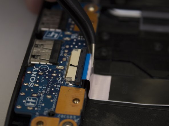

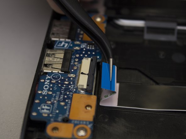

    • Carefully slide the black retainer bar towards the ribbon cable with a nylon supdger until parallel.
    • Carefully pull the ribbon cable out of its socket with a pair of tweezers.

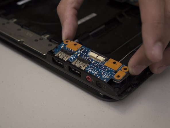

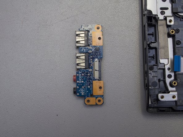

    • Remove the two screws on the corners of the I/O card using a Phillips #0 screwdriver.
    • Lift the edge of the card up and away from the laptop, then pull it away from the side ports.
To put Humpty Dumpty together again, follow these instructions in the reverse order.
