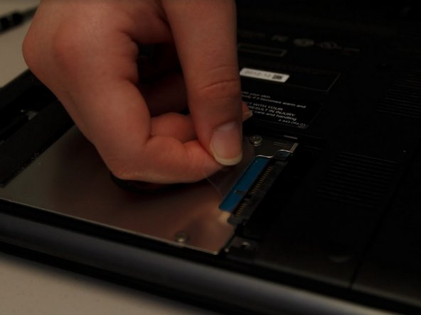

  3. Sony VAIO SVE14AJ16L Hard Drive Replacement: crwdns2935265:03crwdnd2935265:01crwdnd2935265:03crwdne2935265:0 Sony VAIO SVE14AJ16L Hard Drive Replacement: crwdns2935265:03crwdnd2935265:02crwdnd2935265:03crwdne2935265:0 Sony VAIO SVE14AJ16L Hard Drive Replacement: crwdns2935265:03crwdnd2935265:03crwdnd2935265:03crwdne2935265:0
    • Remove the two screws holding the hard drive in place with a Phillips #0 screwdriver.
    • Using the plastic tab, slide the hard drive out away from the main portion of the laptop.
    • Lift the hard drive out of the laptop using the tab.
