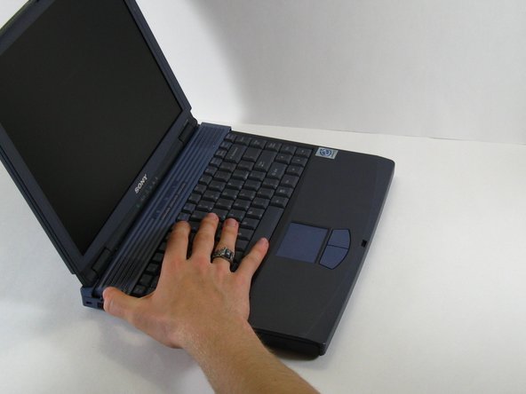

    • Position the laptop screen-side down as shown.
    • In this position the battery housing will be located on the right hand side.

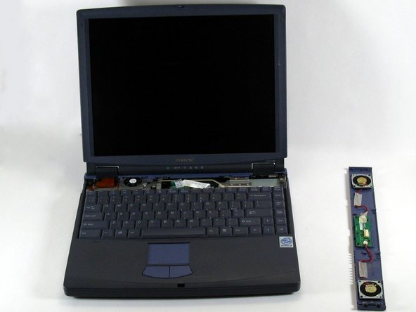

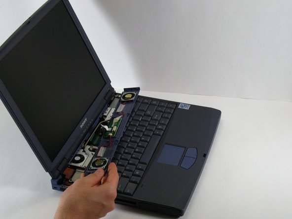

  5. Sony VAIO PCG-F360 Speaker Replacement, Speaker Panel: crwdns2935265:05crwdnd2935265:01crwdnd2935265:03crwdne2935265:0 Sony VAIO PCG-F360 Speaker Replacement, Speaker Panel: crwdns2935265:05crwdnd2935265:02crwdnd2935265:03crwdne2935265:0 Sony VAIO PCG-F360 Speaker Replacement, Speaker Panel: crwdns2935265:05crwdnd2935265:03crwdnd2935265:03crwdne2935265:0
    • There are two screws on the left hand side of the laptop near the IR receiver. remove them using a #00 Philips head screwdriver.
    • Slide the speaker panel towards the left, then carefully flip it over onto the keyboard.
    • Make sure not to pull the speaker panel away from the computer just yet - it is still connected!

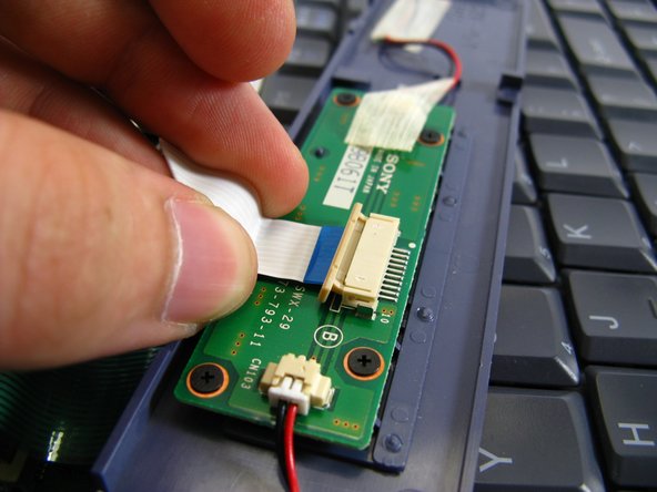

  6. Sony VAIO PCG-F360 Speaker Replacement: crwdns2935265:06crwdnd2935265:01crwdnd2935265:03crwdne2935265:0 Sony VAIO PCG-F360 Speaker Replacement: crwdns2935265:06crwdnd2935265:02crwdnd2935265:03crwdne2935265:0 Sony VAIO PCG-F360 Speaker Replacement: crwdns2935265:06crwdnd2935265:03crwdnd2935265:03crwdne2935265:0
    • Push the beige tab in the direction of the ribbon. it should only move a small amount
    • Remove the ribbon by gently pulling on it, there should be little or no resistance.
    • Now the speaker panel can be set aside.

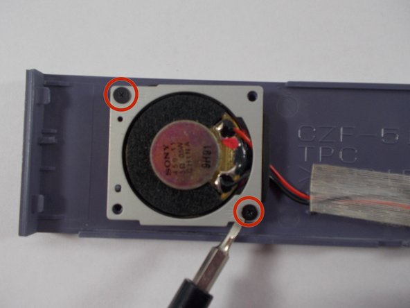

  7. Sony VAIO PCG-F360 Speaker Replacement, Speaker: crwdns2935265:07crwdnd2935265:01crwdnd2935265:02crwdne2935265:0 Sony VAIO PCG-F360 Speaker Replacement, Speaker: crwdns2935265:07crwdnd2935265:02crwdnd2935265:02crwdne2935265:0
    • The two speakers are located on the ends of the panel.
    • There are two screws holding each speaker. Remove them using a #00 Philips head screw driver.
  8. Sony VAIO PCG-F360 Speaker Replacement: crwdns2935265:08crwdnd2935265:01crwdnd2935265:01crwdne2935265:0
    • Carefully flip the speaker over and replace or clean the needed parts.
