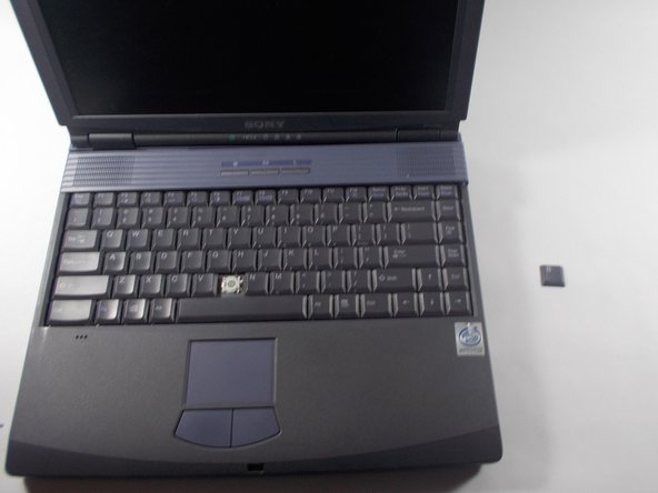

Sony VAIO PCG-F360 Single Key Replacement
    1. Sony VAIO PCG-F360 Single Key Replacement, Battery: crwdns2935265:01crwdnd2935265:01crwdnd2935265:01crwdne2935265:0
      • Position the laptop screen-side down as shown.
      • In this position the battery housing will be located on the right hand side.
    2. Sony VAIO PCG-F360 Single Key Replacement: crwdns2935265:02crwdnd2935265:01crwdnd2935265:01crwdne2935265:0
      • Lift the panel up and then out to gain access to the battery.
    3. Sony VAIO PCG-F360 Single Key Replacement: crwdns2935265:03crwdnd2935265:01crwdnd2935265:01crwdne2935265:0
      • Use the indentations to pull the old battery out.
    4. Sony VAIO PCG-F360 Single Key Replacement: crwdns2935265:04crwdnd2935265:01crwdnd2935265:01crwdne2935265:0
      • The battery is now removed and it is safe to move on to uninstalling other components.
    1. Sony VAIO PCG-F360 Single Key Replacement, Single Key: crwdns2935265:05crwdnd2935265:01crwdnd2935265:03crwdne2935265:0 Sony VAIO PCG-F360 Single Key Replacement, Single Key: crwdns2935265:05crwdnd2935265:02crwdnd2935265:03crwdne2935265:0 Sony VAIO PCG-F360 Single Key Replacement, Single Key: crwdns2935265:05crwdnd2935265:03crwdnd2935265:03crwdne2935265:0
      • Use the pludger to pop off the key by prying under it.
      • You now can clean and replace the key.
