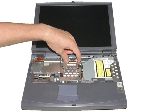

    1. Sony VAIO PCG-933A Thermal Paste Replacement, Thermal Paste: crwdns2935265:08crwdnd2935265:01crwdnd2935265:02crwdne2935265:0 Sony VAIO PCG-933A Thermal Paste Replacement, Thermal Paste: crwdns2935265:08crwdnd2935265:02crwdnd2935265:02crwdne2935265:0
      • Remove the two 4mm Phillips screws in the center of the computer located on each side of the copper electrical strip.

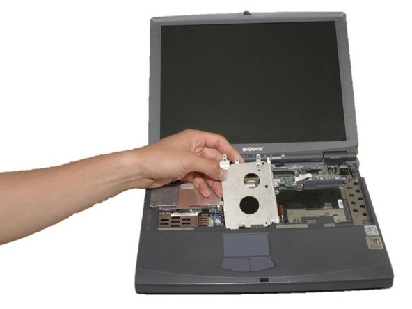

    2. Sony VAIO PCG-933A Thermal Paste Replacement: crwdns2935265:09crwdnd2935265:01crwdnd2935265:03crwdne2935265:0 Sony VAIO PCG-933A Thermal Paste Replacement: crwdns2935265:09crwdnd2935265:02crwdnd2935265:03crwdne2935265:0 Sony VAIO PCG-933A Thermal Paste Replacement: crwdns2935265:09crwdnd2935265:03crwdnd2935265:03crwdne2935265:0
      • Remove the four 4mm Phillips screws around the hard drive cage.
      • WARNING: DVD drive is now loose as well.
      • Lift hard drive cage straight up.
      • Carefully disconnect the copper strip to pull out the hard drive.
    3. Sony VAIO PCG-933A Thermal Paste Replacement: crwdns2935265:010crwdnd2935265:01crwdnd2935265:02crwdne2935265:0 Sony VAIO PCG-933A Thermal Paste Replacement: crwdns2935265:010crwdnd2935265:02crwdnd2935265:02crwdne2935265:0
      • With the hard drive removed, unscrew the four 6mm brass colored, Phillips screws under the hard drive cage
      • This will allow you to remove the hard drive mounting bracket

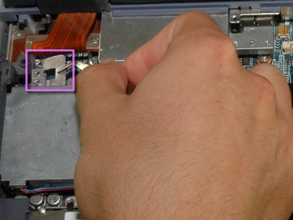

    5. Sony VAIO PCG-933A Thermal Paste Replacement: crwdns2935265:012crwdnd2935265:01crwdnd2935265:02crwdne2935265:0 Sony VAIO PCG-933A Thermal Paste Replacement: crwdns2935265:012crwdnd2935265:02crwdnd2935265:02crwdne2935265:0
      • Remove the two 4mm black Phillips screws shown here.
      • Remove the 18mm silver Phillips screw shown here.
      • Now remove the silver tab.

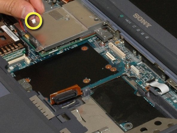

    6. Sony VAIO PCG-933A Thermal Paste Replacement: crwdns2935265:013crwdnd2935265:01crwdnd2935265:02crwdne2935265:0 Sony VAIO PCG-933A Thermal Paste Replacement: crwdns2935265:013crwdnd2935265:02crwdnd2935265:02crwdne2935265:0
      • Remove the blue and red fan power cords.

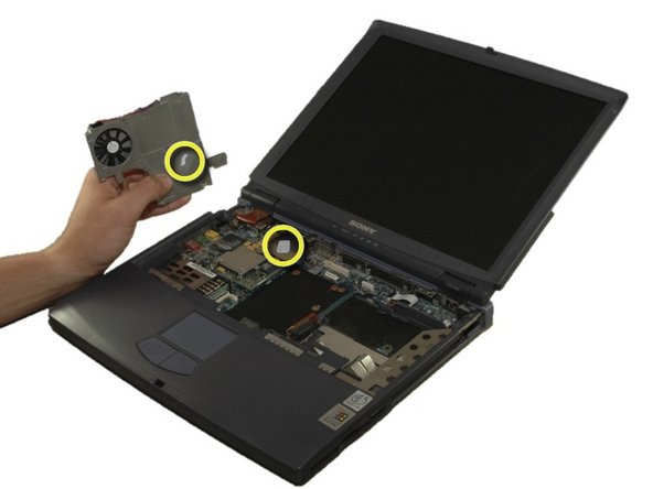

    7. Sony VAIO PCG-933A Thermal Paste Replacement: crwdns2935265:014crwdnd2935265:01crwdnd2935265:02crwdne2935265:0 Sony VAIO PCG-933A Thermal Paste Replacement: crwdns2935265:014crwdnd2935265:02crwdnd2935265:02crwdne2935265:0
      • Carefully pull up and out on the metal heat sink and fan bracket.
      • You should be able to see the thermal paste.
    8. Sony VAIO PCG-933A Thermal Paste Replacement: crwdns2935265:015crwdnd2935265:01crwdnd2935265:01crwdne2935265:0
      • To remove thermal paste thoroughly, put isopropyl alcohol (70% or greater) on a paper towel and wipe thermal paste off. Some force may be required.
      • Apply new thermal paste to CPU.
