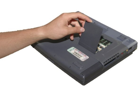

  2. Sony VAIO PCG-933A RAM Replacement: crwdns2935265:02crwdnd2935265:01crwdnd2935265:03crwdne2935265:0 Sony VAIO PCG-933A RAM Replacement: crwdns2935265:02crwdnd2935265:02crwdnd2935265:03crwdne2935265:0 Sony VAIO PCG-933A RAM Replacement: crwdns2935265:02crwdnd2935265:03crwdnd2935265:03crwdne2935265:0
    • As shown by the arrow, slide the plastic cover up and then pull out and downwards.
    • You should now be able to pull the battery out.

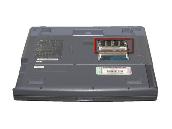

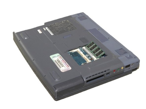

  3. Sony VAIO PCG-933A RAM Replacement, RAM: crwdns2935265:03crwdnd2935265:01crwdnd2935265:01crwdne2935265:0
    • With the laptop facing you, flip the laptop upside down.
  4. Sony VAIO PCG-933A RAM Replacement: crwdns2935265:04crwdnd2935265:01crwdnd2935265:03crwdne2935265:0 Sony VAIO PCG-933A RAM Replacement: crwdns2935265:04crwdnd2935265:02crwdnd2935265:03crwdne2935265:0 Sony VAIO PCG-933A RAM Replacement: crwdns2935265:04crwdnd2935265:03crwdnd2935265:03crwdne2935265:0
    • Remove the 4mm Phillips screw that holds the small panel in the center of the laptop in place.
    • Then remove the panel covering the RAM.
    • The RAM should now be visible.

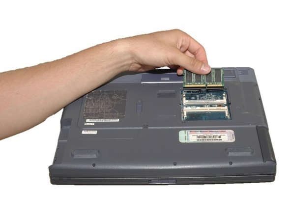

  5. Sony VAIO PCG-933A RAM Replacement: crwdns2935265:05crwdnd2935265:01crwdnd2935265:03crwdne2935265:0 Sony VAIO PCG-933A RAM Replacement: crwdns2935265:05crwdnd2935265:02crwdnd2935265:03crwdne2935265:0 Sony VAIO PCG-933A RAM Replacement: crwdns2935265:05crwdnd2935265:03crwdnd2935265:03crwdne2935265:0
    • Release the plastic switches on each side of the stick of RAM.
    • Carefully slide the stick of RAM out at an angle.
    • DO NOT FORCE OUT.
