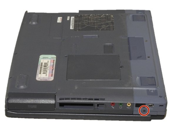

    • Remove the 4mm screw on the right rear side of the laptop next to the audio ports using a Phillips #0 screwdriver.
    • This will release the speaker grille.

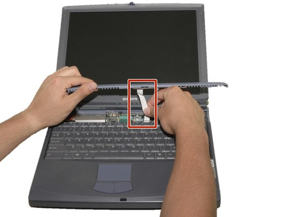

    • Slide the blue speaker grille (located above the keyboard) to the right and gently pull upward. The grille will still be connected by a white electrical strip.
    • Carefully pull out the white electrical strip. By doing this you will remove the speaker grille.

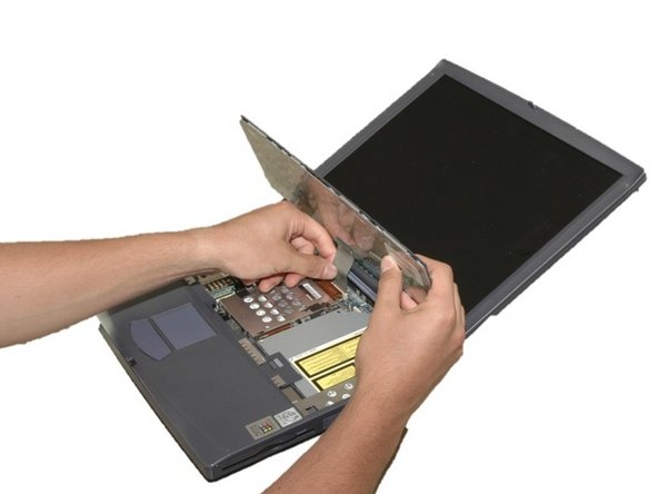

    • Remove the 4mm screw in the center using a Phillips screwdriver.
    • Carefully and slowly pull the green strip straight up (away from the laptop) to disconnect it. Make sure not to pull too hard to avoid breaking.
    • The keyboard can now be removed.
