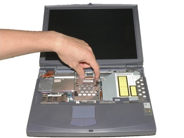

    1. Sony VAIO PCG-933A Hard Drive Replacement, Hard Drive: crwdns2935265:08crwdnd2935265:01crwdnd2935265:02crwdne2935265:0 Sony VAIO PCG-933A Hard Drive Replacement, Hard Drive: crwdns2935265:08crwdnd2935265:02crwdnd2935265:02crwdne2935265:0
      • Remove the two 4mm Phillips screws in the center of the computer located on each side of the copper electrical strip.

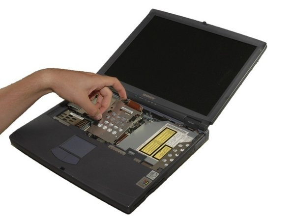

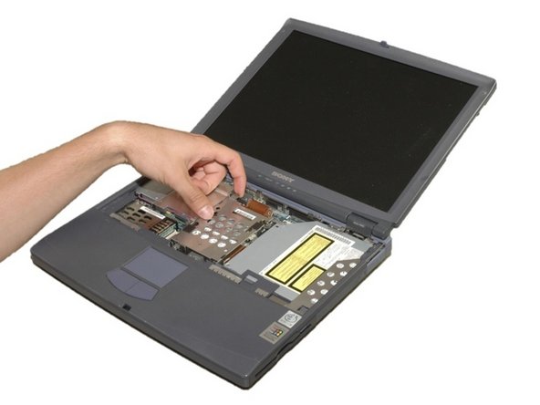

    2. Sony VAIO PCG-933A Hard Drive Replacement: crwdns2935265:09crwdnd2935265:01crwdnd2935265:03crwdne2935265:0 Sony VAIO PCG-933A Hard Drive Replacement: crwdns2935265:09crwdnd2935265:02crwdnd2935265:03crwdne2935265:0 Sony VAIO PCG-933A Hard Drive Replacement: crwdns2935265:09crwdnd2935265:03crwdnd2935265:03crwdne2935265:0
      • Remove the four 4mm Phillips screws around the hard drive cage.
      • WARNING: DVD drive is now loose as well.
      • Carefully lift the hard drive cage out.
      • Carefully disconnect the copper strip to pull out the hard drive.

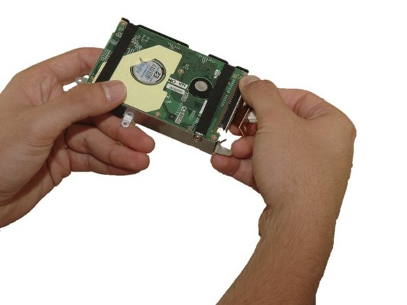

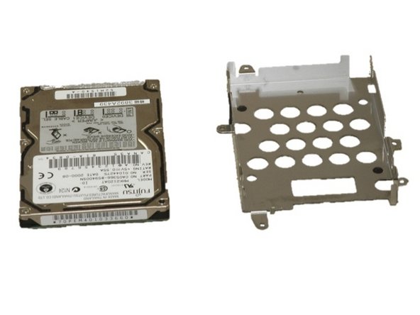

    3. Sony VAIO PCG-933A Hard Drive Replacement: crwdns2935265:010crwdnd2935265:01crwdnd2935265:03crwdne2935265:0 Sony VAIO PCG-933A Hard Drive Replacement: crwdns2935265:010crwdnd2935265:02crwdnd2935265:03crwdne2935265:0 Sony VAIO PCG-933A Hard Drive Replacement: crwdns2935265:010crwdnd2935265:03crwdnd2935265:03crwdne2935265:0
      • Remove the four 4mm Phillips screws that hold the hard drive in the hard drive cage.
      • Gently remove the hard drive from the cage.
      • Gently remove the copper electrical strip from the harddrive.
