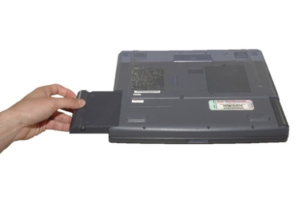

  3. Sony VAIO PCG-933A Floppy Disk Drive Replacement, Floppy Disk Drive: crwdns2935265:03crwdnd2935265:01crwdnd2935265:01crwdne2935265:0

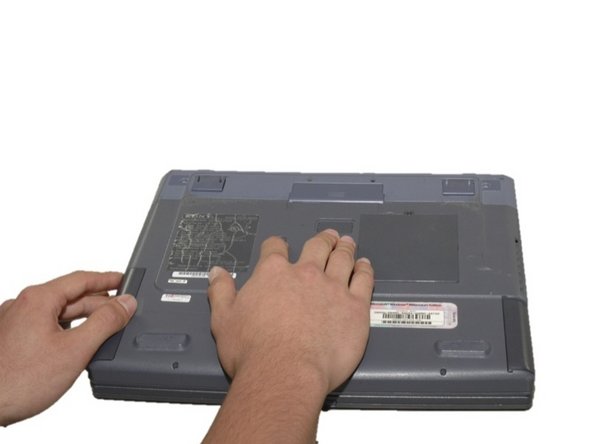

    • With the laptop facing you, turn the laptop upside down.
  4. Sony VAIO PCG-933A Floppy Disk Drive Replacement: crwdns2935265:04crwdnd2935265:01crwdnd2935265:03crwdne2935265:0 Sony VAIO PCG-933A Floppy Disk Drive Replacement: crwdns2935265:04crwdnd2935265:02crwdnd2935265:03crwdne2935265:0 Sony VAIO PCG-933A Floppy Disk Drive Replacement: crwdns2935265:04crwdnd2935265:03crwdnd2935265:03crwdne2935265:0
    • Locate the release switch in the center of the laptop, shown here.
    • Slide the switch, and hold in place. The floppy disk drive is now free and should easily slide out.
  5. Sony VAIO PCG-933A Floppy Disk Drive Replacement: crwdns2935265:05crwdnd2935265:01crwdnd2935265:01crwdne2935265:0
    • To replace, insert the new floppy disk drive with the wording facing down.
