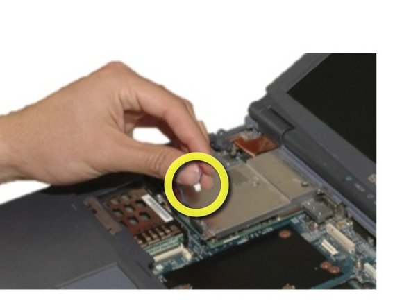

      • Remove the 4mm screw in the center using a Phillips screwdriver.
      • Carefully and slowly pull the green strip straight up (away from the laptop) to disconnect it. Make sure not to pull too hard to avoid breaking.
      • The keyboard can now be removed.

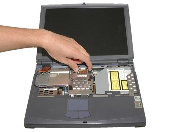

      • Remove the four 4mm Phillips screws around the hard drive.
      • WARNING: DVD drive is now loose as well
      • Carefully lift the hard drive cage out.
      • Carefully disconnect the copper strip to pull out the hard drive.

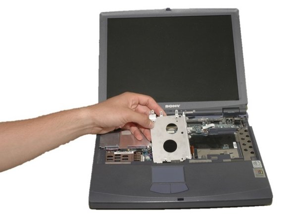

    2. Sony VAIO PCG-933A Fan Replacement: crwdns2935265:09crwdnd2935265:01crwdnd2935265:02crwdne2935265:0 Sony VAIO PCG-933A Fan Replacement: crwdns2935265:09crwdnd2935265:02crwdnd2935265:02crwdne2935265:0
      • With the hard drive removed, unscrew the four 6mm brass colored, Phillips screws under the hard drive cage.
      • This will allow you to remove the hard drive mounting bracket.

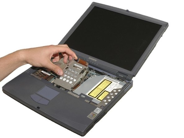

      • Remove the three 6mm brass colored, Phillips screws that hold the fan cage in place.

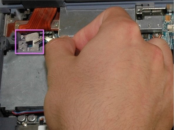

      • Remove the two 4mm black, Phillips screws shown here.
      • Remove the 18mm silver, Phillips screw shown here.
      • Now remove the silver tab.

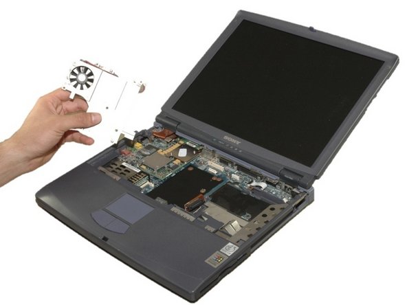

      • Carefully pull up and out on the metal heat sink and fan bracket.
      • The fan can now be cleaned or replaced.
