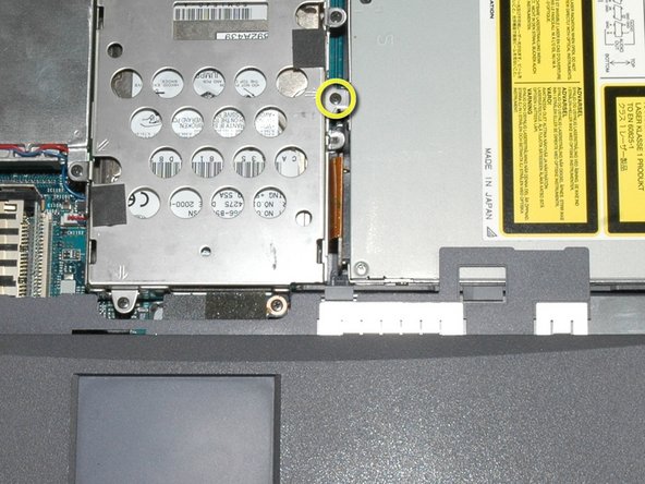

  8. Sony VAIO PCG-933A DVD Drive Replacement, DVD Drive: crwdns2935265:08crwdnd2935265:01crwdnd2935265:02crwdne2935265:0 Sony VAIO PCG-933A DVD Drive Replacement, DVD Drive: crwdns2935265:08crwdnd2935265:02crwdnd2935265:02crwdne2935265:0
    • Remove the 4mm Phillips screw that connects the hard drive cage to the DVD drive.
    • Carefully remove the copper wire strip.
  9. Sony VAIO PCG-933A DVD Drive Replacement: crwdns2935265:09crwdnd2935265:01crwdnd2935265:03crwdne2935265:0 Sony VAIO PCG-933A DVD Drive Replacement: crwdns2935265:09crwdnd2935265:02crwdnd2935265:03crwdne2935265:0 Sony VAIO PCG-933A DVD Drive Replacement: crwdns2935265:09crwdnd2935265:03crwdnd2935265:03crwdne2935265:0
    • Slide the DVD drive out.
