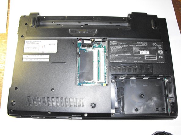

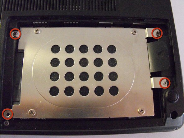

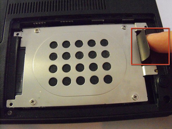

    • Next loosen the hard drive cover screws as shown (marked with red indicators picture 1) And remove the hard drive bay cover.
    • Remove screws from indicated areas (picture 2).
    • place screws in a safe location or container (I use powerade bottle caps to separate screws from different parts of a project)
    • Use the tab (indicated in picture 3) to pull the hard drive to the side and lift it free.

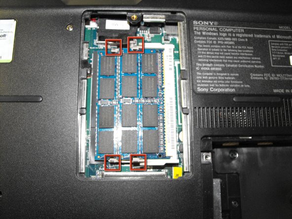

    • Loosen the screw marked (indicated in the red circle) and pull the RAM bay cover free. (the cover has plastic tabs on the sides and may take a few tries to free it.)
    • push the metal tabs on either side of the RAM chips, making them lean up slightly, and pull both chips free

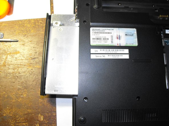

    • Remove 2 screws (indicated in first picture).
    • Pull CD drive from the laptop.

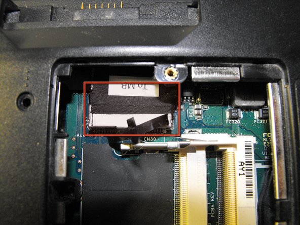

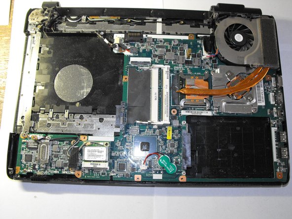

  7. Sony VAIO PCG-61411L Teardown: crwdns2935265:07crwdnd2935265:01crwdnd2935265:02crwdne2935265:0 Sony VAIO PCG-61411L Teardown: crwdns2935265:07crwdnd2935265:02crwdnd2935265:02crwdne2935265:0
    • Begin unplugging cords from the motherboard in designated locations

As a matter of fact there are 20 (not 15) small black screws (in addition to the 3 silver ones) that hold down the bottom casing. Also, I could not pull the tab in the RAM bay, but was able to rotate the bottom casing around that cable to access the fan, which needed cleaning.

How about an actual Sony part number for the hard drive caddy that this model used? User removed the drive and tray, then lost both. I can fit an SSD into place but have to use some high-density packing foam to keep it from sliding off the connector. Can't find a service manual for this unit anywhere, let alone a drive caddy, and especially not when I have no idea what it really looks like, except from the 2 pics you have of it, but there's a number of them that look the same. Thx.
