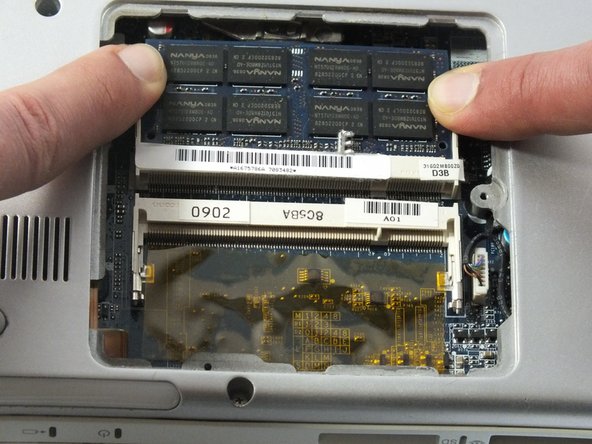

    • Using a #00 Phillips screwdriver, remove the screw
    • Remove the cover
  2. Sony VAIO PCG-3E2L RAM Replacement: crwdns2935265:02crwdnd2935265:01crwdnd2935265:03crwdne2935265:0 Sony VAIO PCG-3E2L RAM Replacement: crwdns2935265:02crwdnd2935265:02crwdnd2935265:03crwdne2935265:0 Sony VAIO PCG-3E2L RAM Replacement: crwdns2935265:02crwdnd2935265:03crwdnd2935265:03crwdne2935265:0
    • Use two thumbs to push two plastic around RAM outward.
    • Remove the popped up RAM
  3. Sony VAIO PCG-3E2L RAM Replacement: crwdns2935265:03crwdnd2935265:01crwdnd2935265:02crwdne2935265:0 Sony VAIO PCG-3E2L RAM Replacement: crwdns2935265:03crwdnd2935265:02crwdnd2935265:02crwdne2935265:0
    • Use two thumbs to push two plastic around the other RAM outward.
